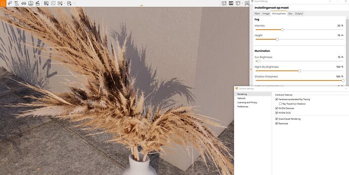

To clarify the problem, I have pushed the shadows to 100% to see the difference the best.
I first saw some weird shadows with some plants, apparently they don’t let ‘the light through’ the alpha layers, while others do.
To Illustrate I have 4 examples. The first and third are with raytracing, the second and fourth are WITHOUT. (all on ultra)
EDIT: I found out that the one which is not letting the light through, has been added through Enscape itself. The correct one has been added via Sketchup.
EDIT2: Weirdly I cannot reproduce the issue. When I have it again, I will return.
With raytracing: At the fountaingrass, it is very hard/squared. Also inside the grass-part itself it gets very dark because of this. The vase has perfect lining.
Without raytracing
Second pair of examples below.
With raytracing
Without
