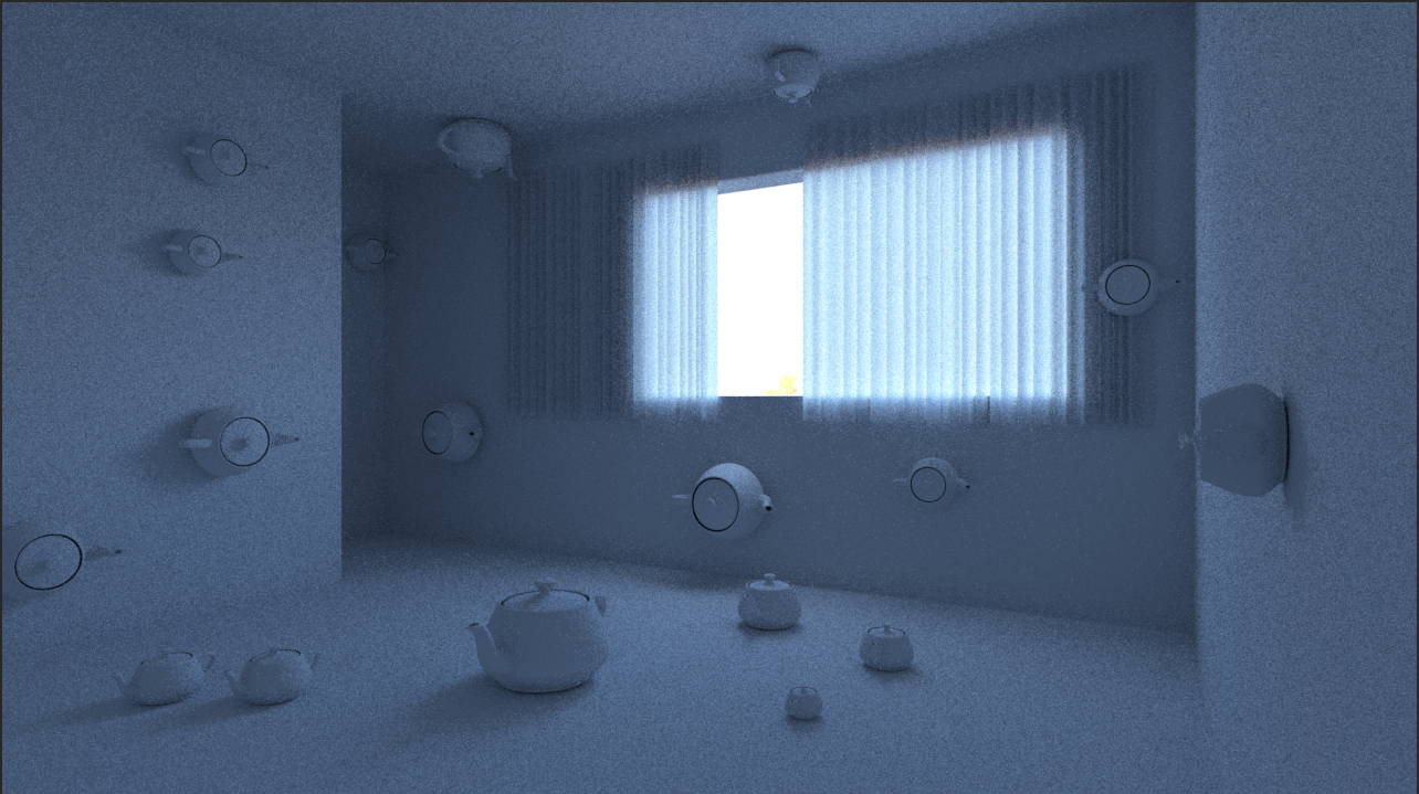

curtain ans some 2 sides material... help
i dont want any faking solution
i want to put curtain on windows (2 side material) and go render without to find that i add a full of noise to my scene
im sorry but i must to understand why corona engine can do it easily??
vray - dome light - hdri - setting bf - lc the rest is out of the box
corona - hdri on environment - setting - out of the box
its just like that or what wrong?
link to image :
https://postimg.org/image/8jifkb1sv/

Post your scene ? Or you don’t want any “faking solution” ?
no i dont want “faking solution” i will post the simple scene and i really want to understand why other engine deal with 2 side material so well

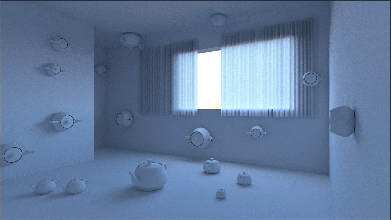

can you post full resolution corona render to compare ?

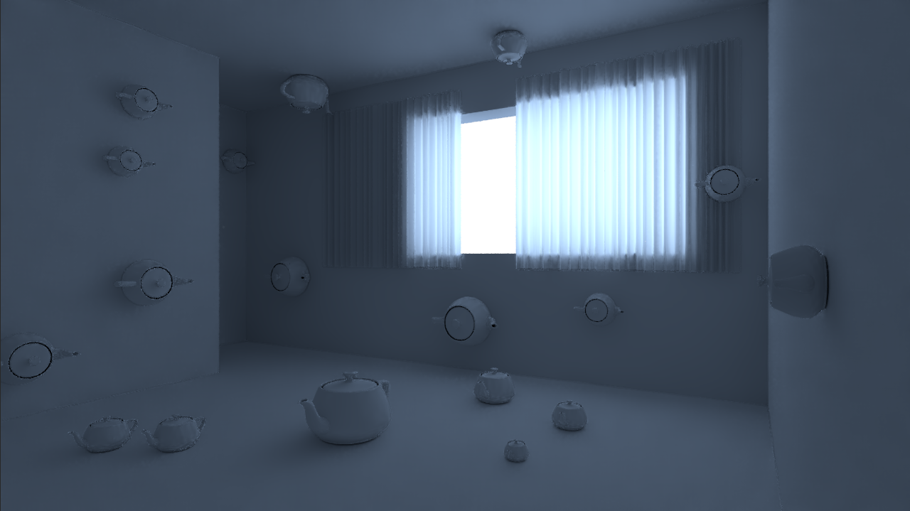

This is what i got with denoiser and some tweaks https://dl.dropboxusercontent.com/s/7p056pd799ypod9/shot\_161127\_201517.png
rendertime with denoiser is 1 minute 40 secs on my weak laptop.

its full of glitches and splotches
its better to have noise and not things like that man
denoiser ans irradiance map kill your test man
Well this is not irradiance map, this is bruteforce with denoiser. But you wanted crystal sharp image for one minute ? You live in a dream world, mate :slight_smile:

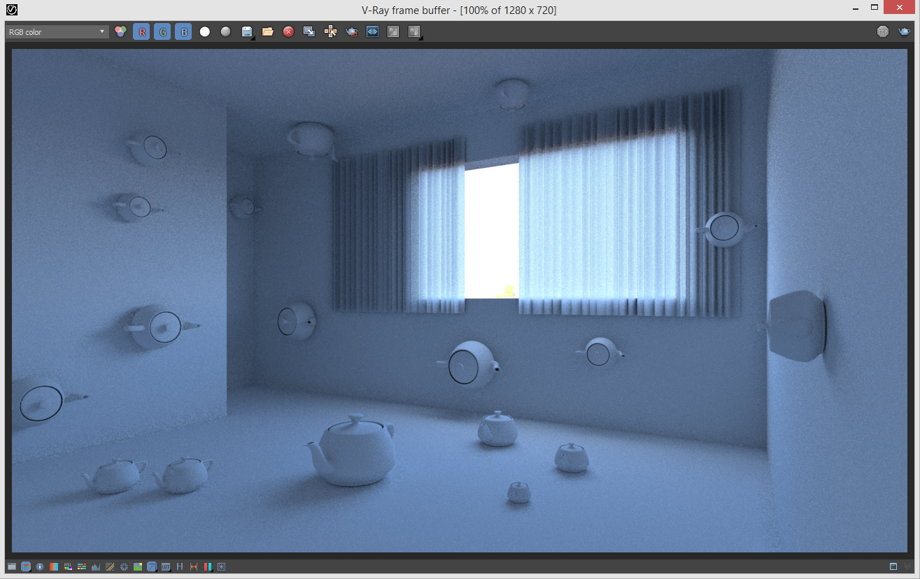

This is what i get without denoiser.

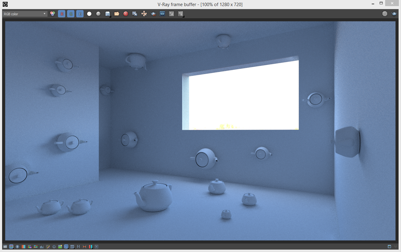

This is without curtains
This is with curtains excluded from shadow casting of light portal
The same as above, but using VrayOverride material and in GI slot - simple VrayMaterial with VRayColor in opacity slot
Last one is the cleanest image and is just slightly noisier than example without curtains.

its show the corona is much more cleaner in same time of render
