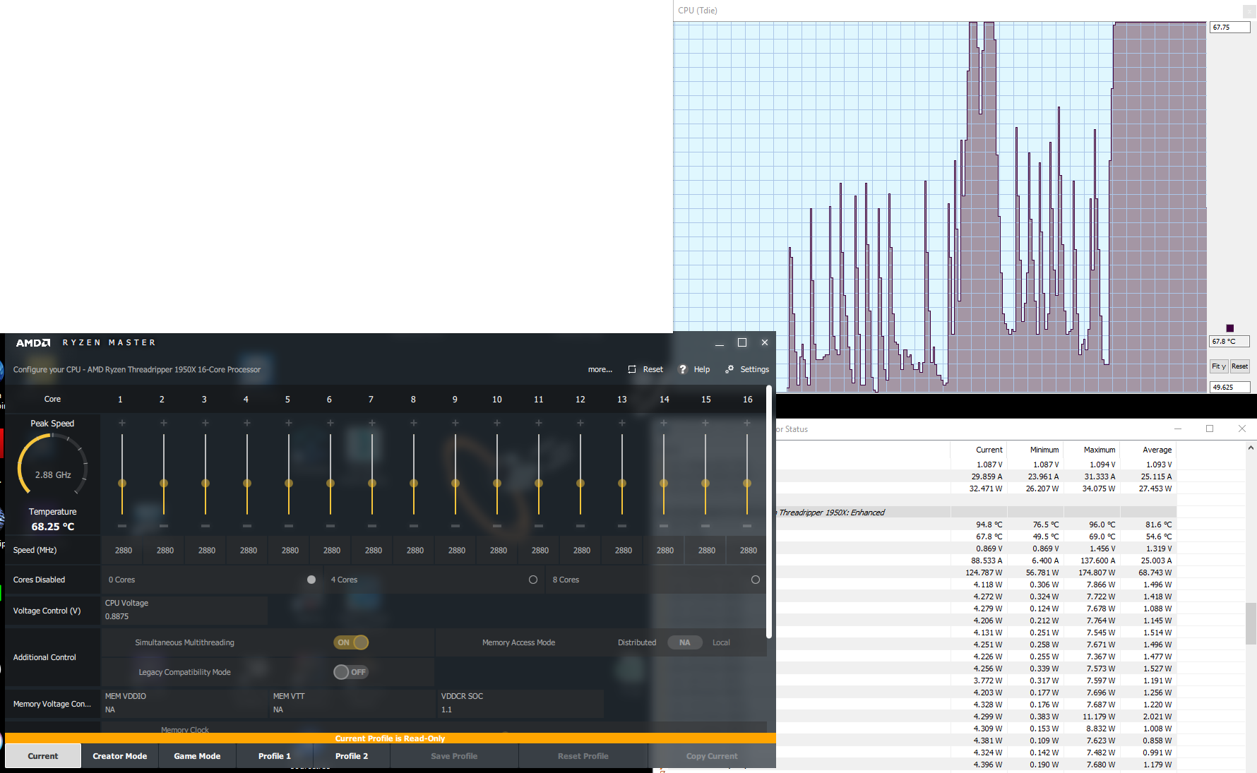

Here is a test i’ve done:
As you can see the idling spikes I have. And on the load the CPU speed dropped to 3.0 ghz. with voltage 0.9, while on idle it is 3.7 and 1.3 voltage. Do you think I can set that up through AMD Ryzen software to be constant 3.7 ?
but I think should do it’s job

This means it is not a hardware problem. You aiSuite or some Asus app is causing this behavior most likely
I am using HWInfo and right now when idle I am getting 49 - 56C
Good idle temps. But problem is that is not consistent. It jumps around without a reason. Can you check if somthing runs at background causing CPU usage at idle?
Also now under the full load I am getting around 65C, which is ok, I believe?
Good temps.. no worries at all
I believe that is normal behaviour?
It is normal if it jumps to 3.7 even on idle.. what is not normal is fans kicking on idle
That started to happen when i’ve tried to set voltage for CPU manually from Bios
by default, Core voltage will go way above 1.35v.. so there is no problem if you use manual Core voltage
There is something in the background causing this idle spikes.. If not Ryzen master app and Asus apps has gone crazy
This is normal. with all cores in use, any CPU don’t run at max frequency(unless it is overclocked)
Usually it reaches turbo frequency with one or 2 core under load.
this is not supposed t happen

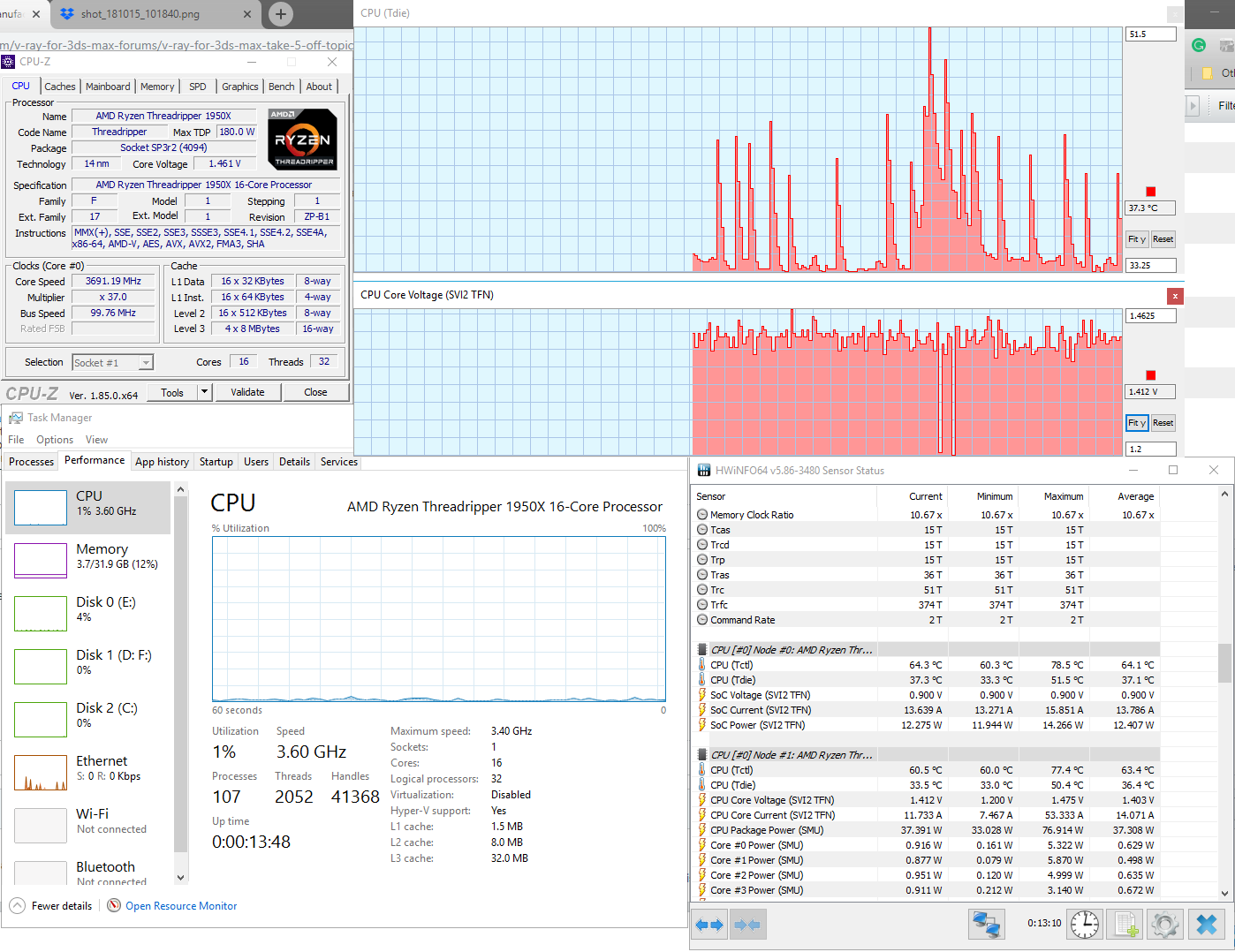

Hi Muhammed,
So here are graphs on bios defaults and with uninstalled AI suite and AMD Ryzen utility: https://dl.dropboxusercontent.com/s/dti6mxhribozzmp/shot\_181015\_102133.png
Still, there are spikes, and CPU utilization is not going higher than 1%. I see that voltage is kicking in making CPU go up to 4.0, looks like turbo boost and it makes my fan spin faster when temperatures rise.
Fans are still kicking in, without AI suite looks like it is working constantly on about 60% (judging by the noise), going up to 70% when the temperature rises.

Sorry for taking that long to get back to you. The board I worked on had the same fans issue, I did a windows reset and everything worked nicely then
It is 100% software.. I would recommend not touching any oc settings or fan controls inside windows. You better do this from bios
Also you should install AIsuite and all its components if you haven’t already.
