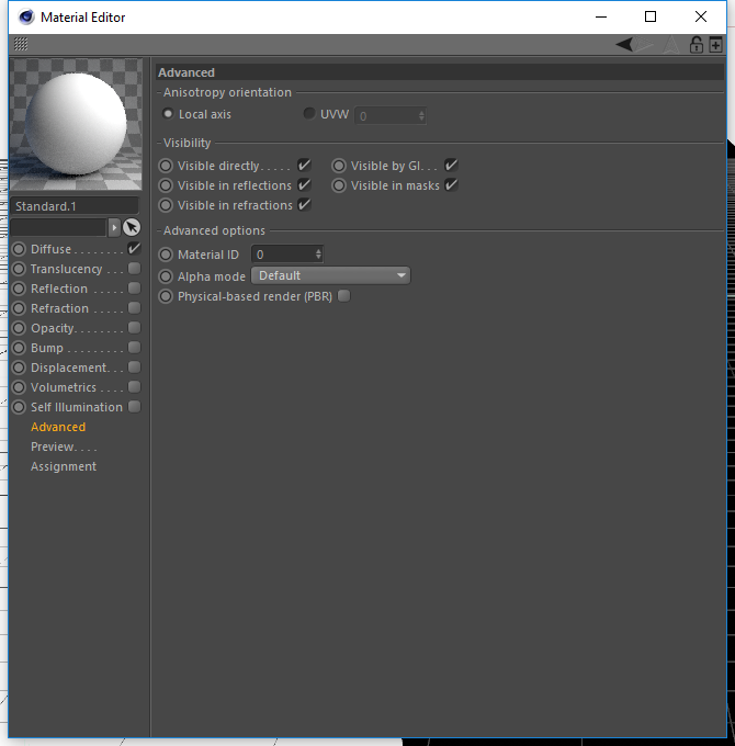

The problems with сorona сompositing tag is still exist. When i switch off cast shadows, the object still drops shadow, and the same about “seen by GI” tag, even now it impossible to switch off cast shadows in material advanced options, because there is no this option.
