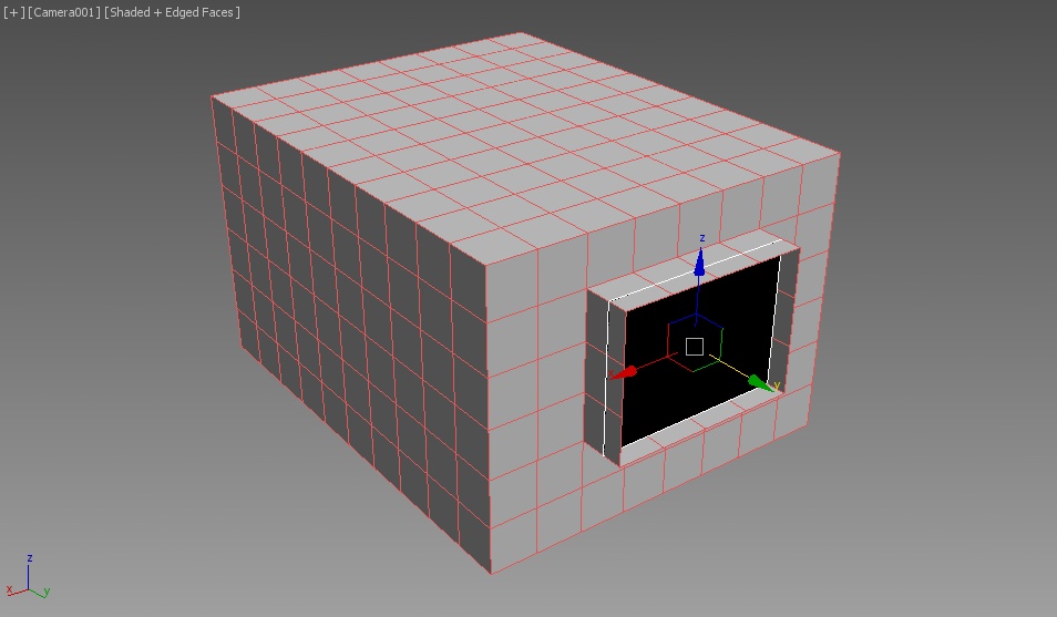

Because there shouldn’t be any “obstacles” behind the portals. I do not know the tech behind it, but even Ondrej said there is no way to be 100% sure if portal will speed things up or not, you just have to try it. And comparing different configurations is not very time-consuming. You can select a region, or render only a few passes. Placing the portal in the door frame would be pretty much like in this example, only more extreme:

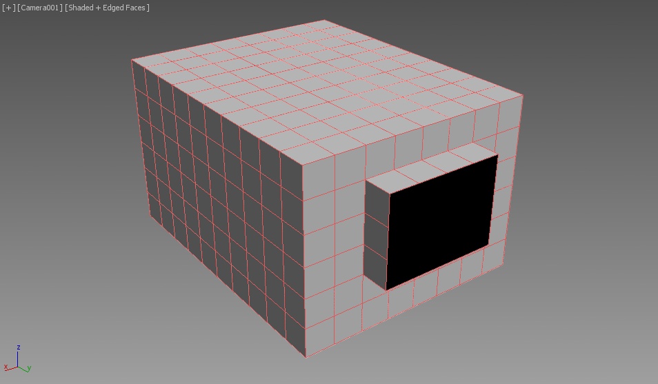

and it should be like this:
( see more here: https://coronarenderer.freshdesk.com/support/solutions/articles/5000501660 )
