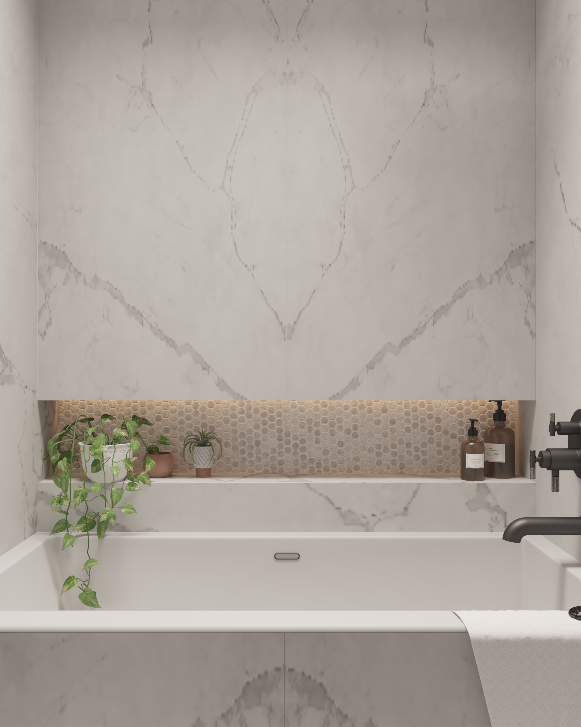

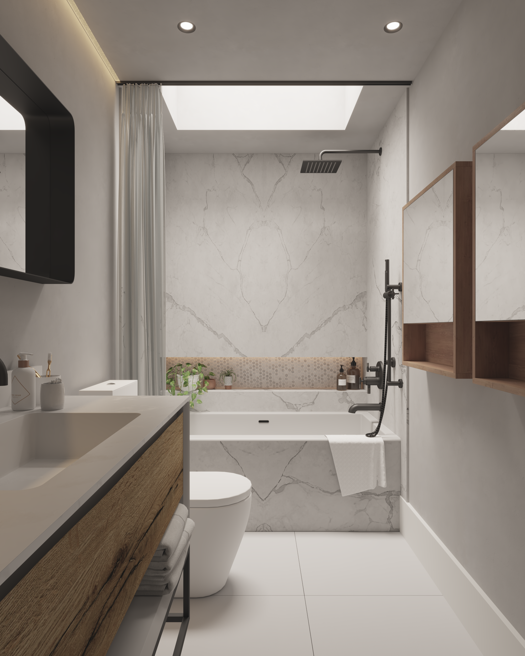

I previously used CPU rendering as my last GPU was a 1080Ti so was getting a little old for decent GPU rendering times. Now I have a 3080Ti so switched on GPU rendering. No other changes. Here is the scene as it was rendered via CPU a week or so ago:
Then here’s what I get if I flick it to GPU and hit render now:

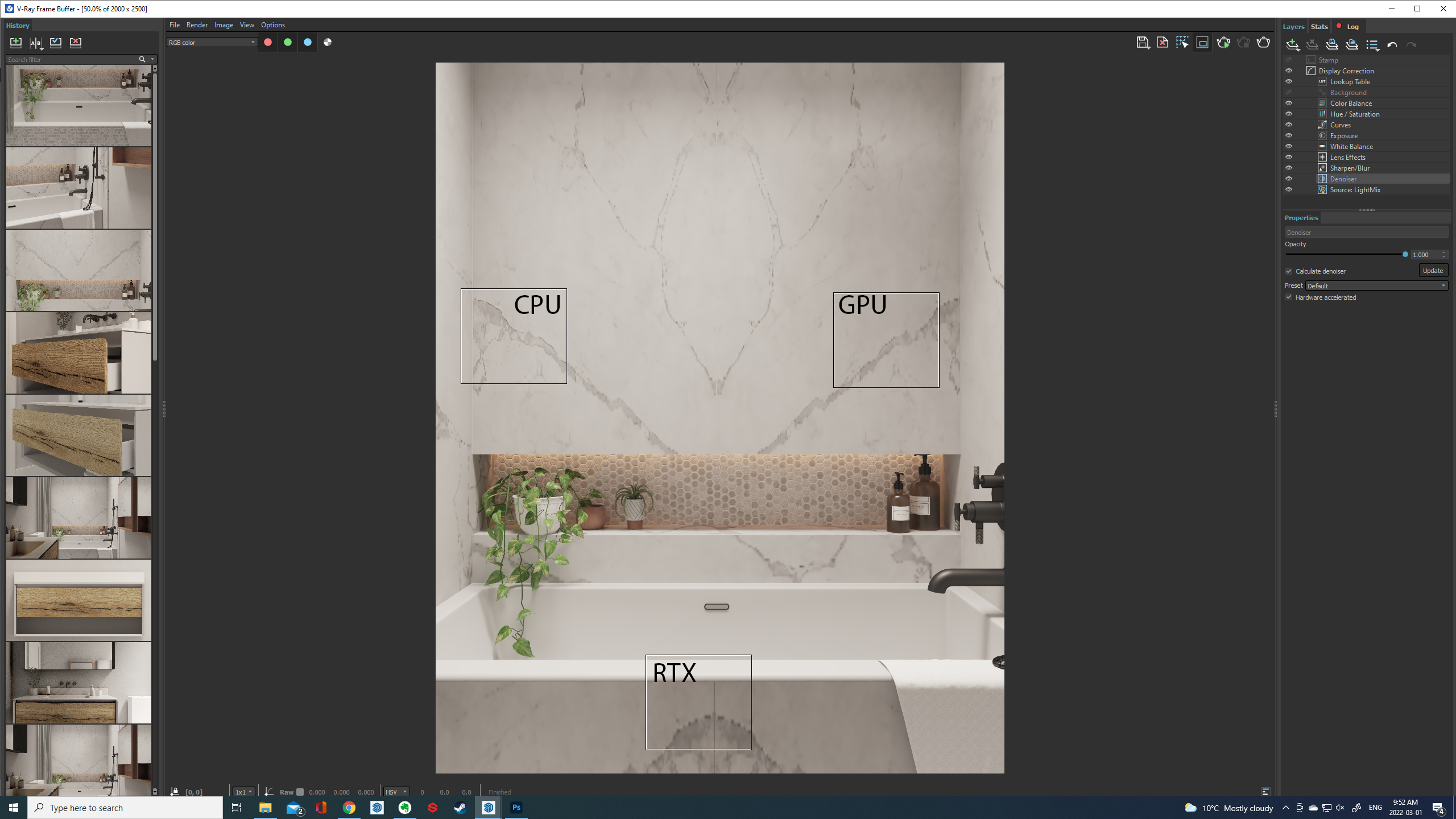

The marble is very blurry/pixellated. If I switch back to CPU then it looks fine. Here’s a comparison of the three render engines:

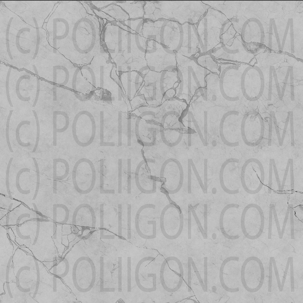

And here’s an example of the quality of the map in the material (which is correctly linked):
It’s an 8k image.

OK - I stumbled across a setting that seems to have resolved this. In V-Ray, under the V-Ray GPU rollout, the default setting seems to be to significantly down-sample textures to just 0.5k. I’m sure this speeds up rendering but obviously degrades quality a lot. I’d have thought that the default setting should probably be to use full-size textures and let people decide for themselves whether they want to downsample them, but there you go.
Hi @andy_smith ,
The default behavior is using Full-size textures actually, I just checked.
FYI Resize is more about optimizing GPU memory than rendering speed. It can reduce GPU usage drastically to allow you to build a bigger scene.
