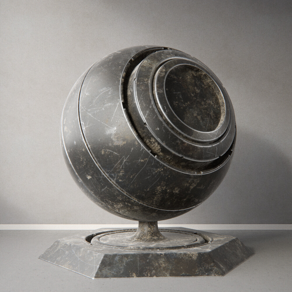

Corona Material
  • I have converted my Quixel MegaScan materials over to Substance Painter.
    In this example we will use “Dirty Scratched Painted Steel”, as it has both metal and plastic.
Export all the masks by right clicking and "Export mask to file".
Disable all the masks by right clicking and "Toggle mask".
Disable all the materials. Enable one at a time and export them separately.
Normal maps auto blend in Substance Painter by default, so you need to disable them.
**01 Steel Base**
**02 Paint**
**03 Muddy Dirt (This one could use some SSS)**
**04 Dirt**
**Final Material**
**Dirty Steel Material**
