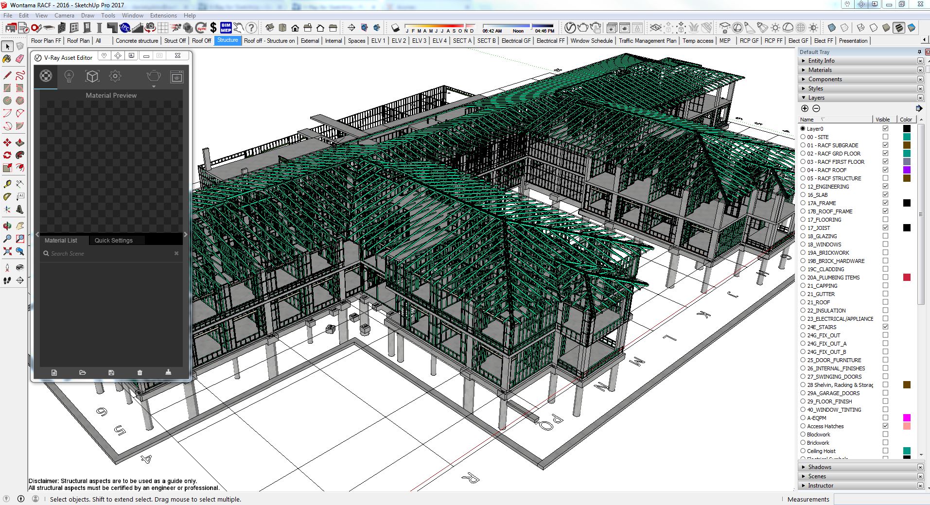

Hi there,
Having a few issues getting Vray to actually recognise some models, relatively simple (not much in the way of group/component/layer hierarchy) are recognised instantly but larger files like below just don’t show up at all. I’ve tried all sorts of things like exploding groups, amalgamating/deleting layers but to no avail.
Obviously my work-flow wasn’t based around Vray and I suspect I have a layering/grouping issue rather than an actual bug, so wondering if anyone else has seen this and found red flags to look for?
I draw primarily with Plusspec in SU17 with Vray3 (Trial).
Any suggestions would be much appreciated.
