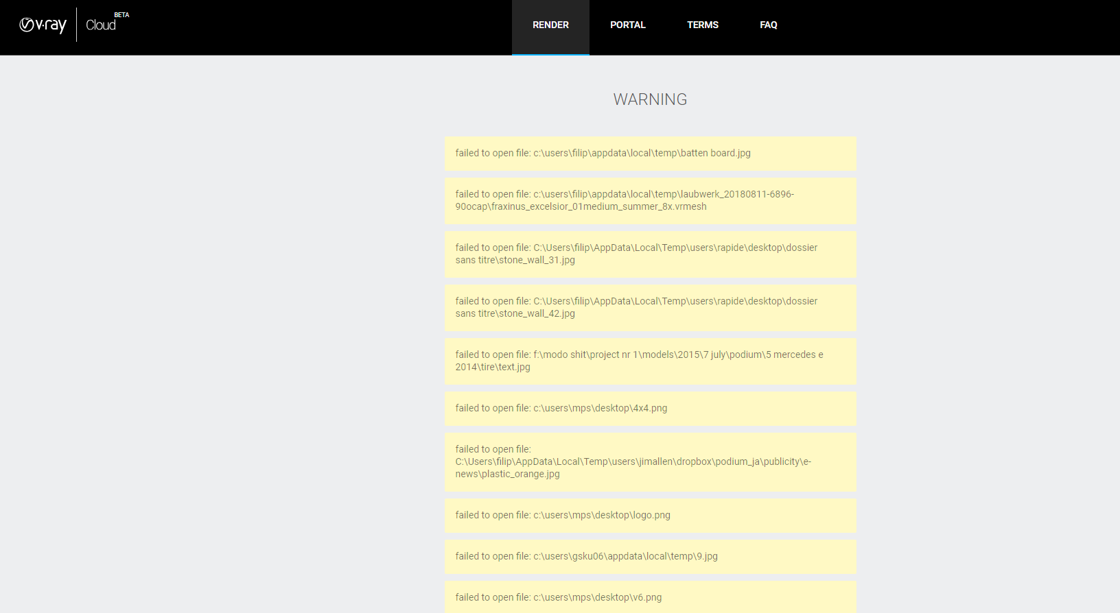

I get this error when I try to render it with cloud. I didn’t find any solution on FAQ.
Could you please help?
Thank you!
Hello,
The texture files which could not be loaded reside in various users’ temp locations. Make sure your current user has permissions to read files these files before submitting the render job.

Hello!
I have the same problem @fprpic has… @Peter.Chaushev - what do you mean by "your current user has permissions to read files "? Can you put some light on it?

Diffuse textures files for most materials are embedded within the SketchUp project file. When you open the file, SketchUp exports all embedded image files to a temporary location on your hard drive for the duration of the session. In the screenshot fprpic shared back in August, some of the files reside in temp locations of other users.
Keep in mind, despite these errors, the rendered image should be ok. If this is not the case, please let us know by emailing at support@chaosgroup.com

Indeed - image looks fine even with those warnigs before. Thanks for advice.
