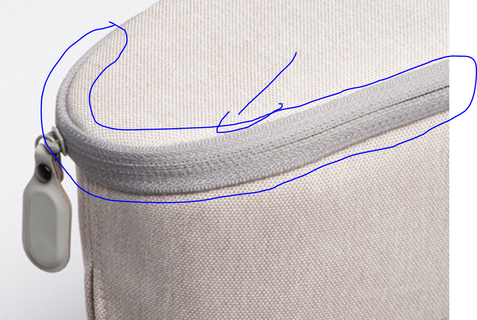

I dont know how to approach this kind of Zipper texture. Please find below.
Its going to be printed.
Do i have to model it?
Can i do it completely with texturing Displace map? Do you know any tutorials?
Thanks
Do you have to show your zipper open at all? If not I would model the extrusion the zipper creates and then place a zipper texture on top.
A quick google search later and I found a zipper that looks visually similar, and should be good enough to make a displacement/bump map out of.
Gluck
Anyone tried Corona Scatter along splines, using a step for regular placement? Should let you bend the spline, to have an open or closed zipper
