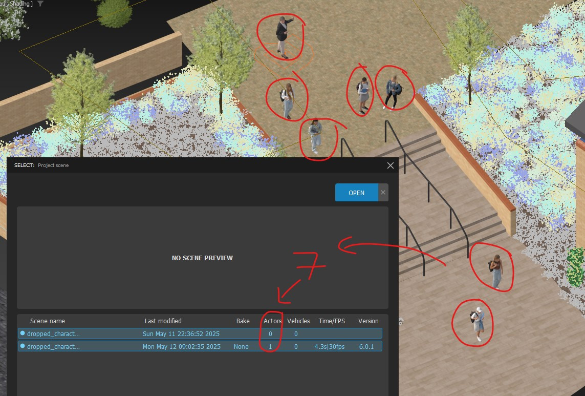

    Hi All,
    I have seen a few posts regarding anima 6 drop, that has gone unanswered by admin?
    I am also having issue with anima drop in 6, worked perfect in 5.
    I spent hour setting up a scene, adding and positioning people. Saved and closed the scene.
    Reopened the scene, the little triangle markers display where the people were then they disappear.
    I tried again readded 7 people(actors), but when I click on the scenes it only says there is 1 actor in the scene?
    I saved, closed down the scene and reopened and yet again all the people disappeared??
    clearly some bug? so having to roll back to anima 5.
    anybody else have any issues? i am using max 2023.
    Thank you​

      I just rolled back to anima 5 and opened my scene that I created with anima 6, and now all my people re-appeared.
      So 100% a bug/error with anima 6 drop which needs an update and quick to fix.
