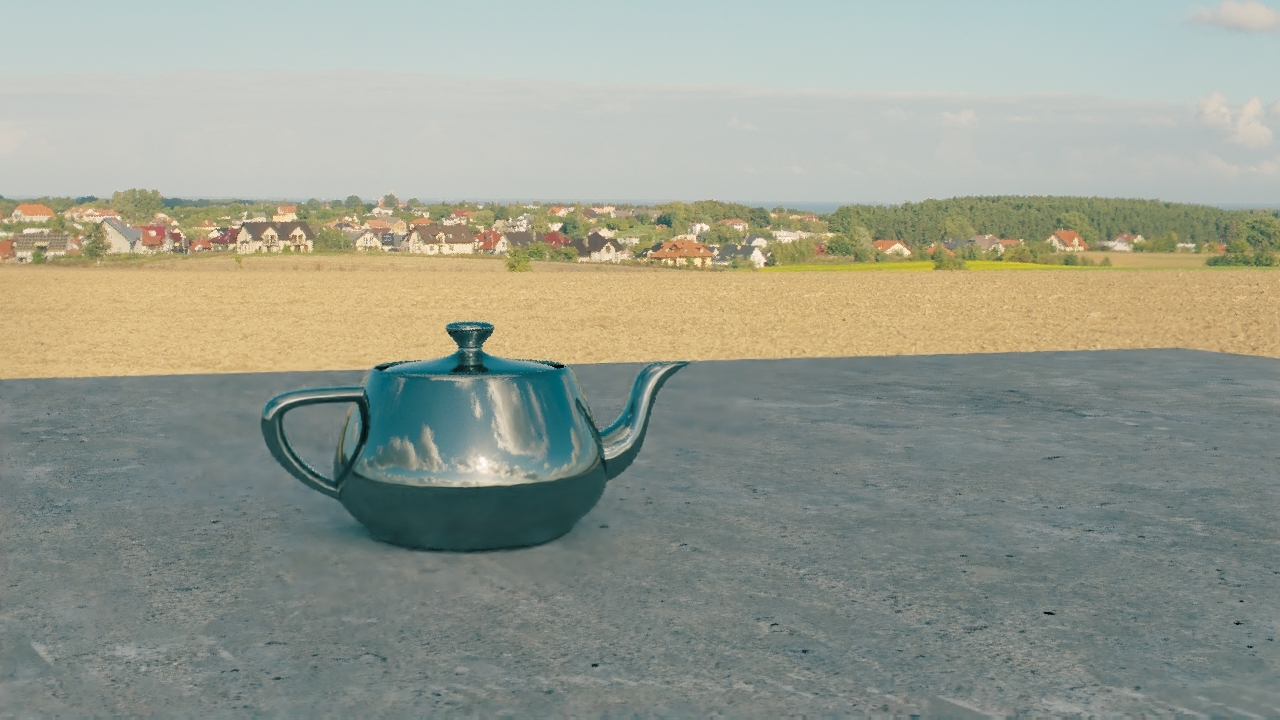

      I upload my evidence,
      1. image as it appears on my computer

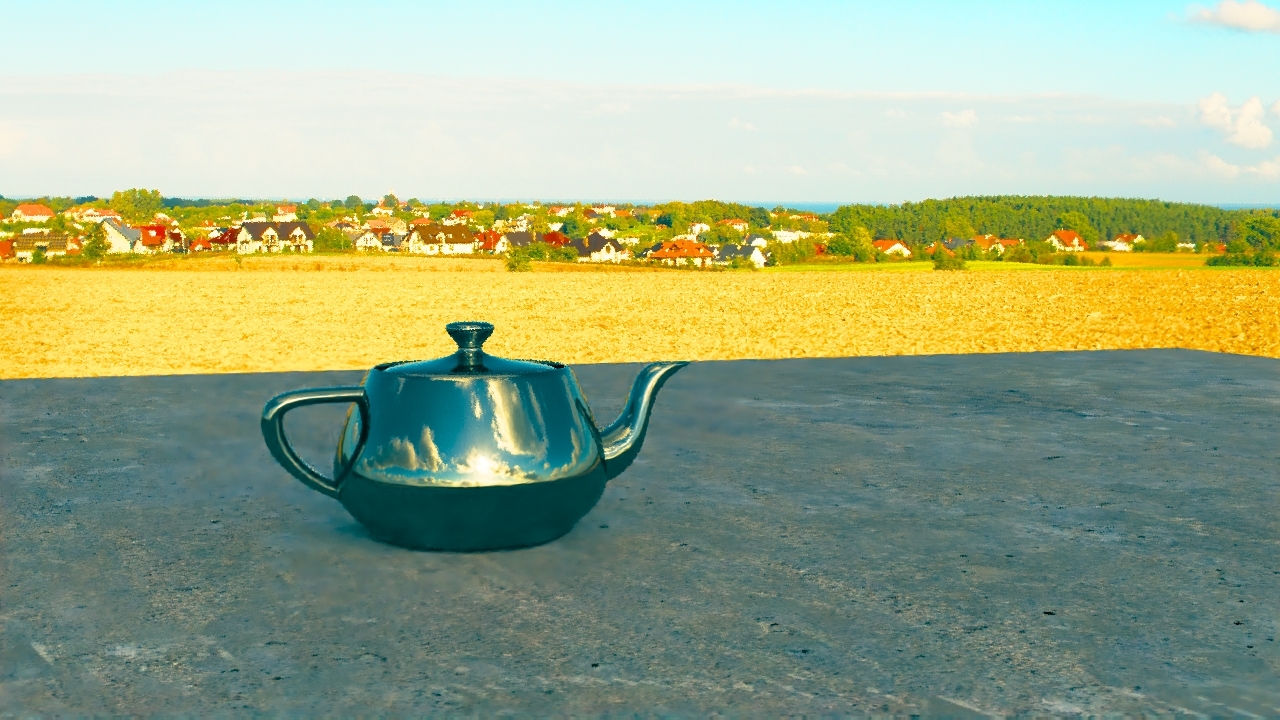

      2. 2. this is the result obtained in chaos cloud

        Hi kino_unico,
        The LUT is currently no applied in Chaos Cloud. This logged as CLOUD-1517 to our bug-tracker and we will notify you when we have any progress.
        As a workaround, you can open the .exr file in VFB2, apply the LUT from the Layers, and then save the current channel or as separate files.
