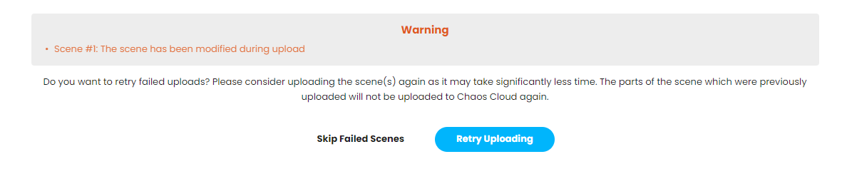

    Hey guys, recently we have this issue.
    When ever we try to upload a job, it starts uploading, jumps to 100% and cancels the upload with this error.
    What could be a problem? We tried exporting to vrscene and uploading it, same thing happens.
    We are using Sketchup and Vray 6.01

          i have just had this error too, cant upload.

            so, havent a clue whats going on, but i tried a different scene..it uploaded...made some changes to scene and the error came back...made a test scene with a couple of spheres...it wont upload. I really need the cloud to work today but no.

                Ok, so I just created a scene with couple spheres, clicked submit, validated fine, got the same error 'scene was modified'. Any idea on how were they being modified? I just clicked upload.

                    Very strange indeed. This is the only error in the logs. I've managed to submit the .vrscene file that you shared through the standalone interface of the Chaos Cloud client app. I will need some help from my colleagues with this one. But I guess we'll be able to follow up on Monday. Hope it's not too late.
                    Meanwhile can you use the manual V-Ray exporter from the V-Ray menu and submit the exported .vrscene through the standalone interface of the Chaos Cloud client app? It seems to work that way.

                        Ok, so that worked..im wondering if its something wrong at my end. After trying it this way, i tried submitting the normal way, both in chrome and firefox, and the error was there again.
