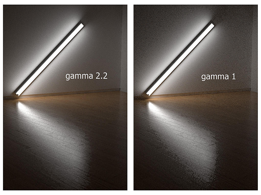

              • #37
                yep, I think for the daytime ones, I just rendered out to pngs as I didnt need to do much post work (so "don't affect colours (adaptation only)" was OFF), whereas the night ones would have been to exr, with "don't affect colours" ON. I would have kept it reinhard with burn and gamma 2.2 though as it still affects the adaptation (as the name implies).
                I've attached an example showing what an exr (opened and saved in photoshop with no adjustments) rendered with "don't affect colours" ON looks like with gamma 2.2 and gamma 1. As you can see, the colours are indeed the same, just the adaptation differs. The gamma 2.2 one took slightly longer, as it obviously has had more work to do.
                Hope that makes sense, and hope someone will correct me if I'm talking BS...
                www.peterguthrie.net
                www.peterguthrie.net/blog/
                www.pg-skies.net/
                • #38
                  I think I understand, its late in the day! The 2.2 image is much better quality. Interesting to see.
