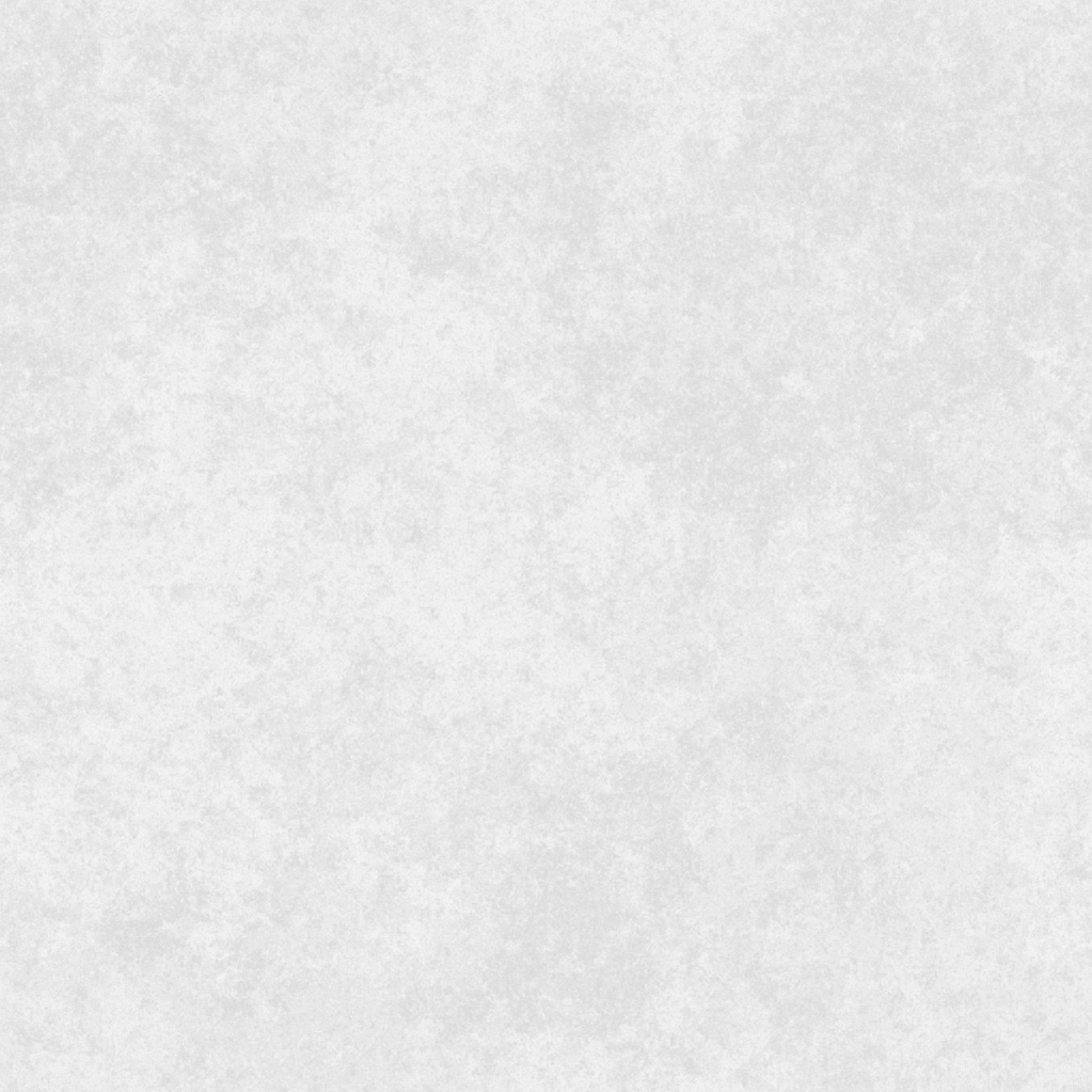

                  Hello,
                  Thank you for the nice comments
                  Here are the two last materials (white, and transparent white) with the map used.
                  For the wall it's a simple Vraymat (almost white) with a bump map
                  www.mirage-cg.com
                    Thanks waaazo for sharing.
