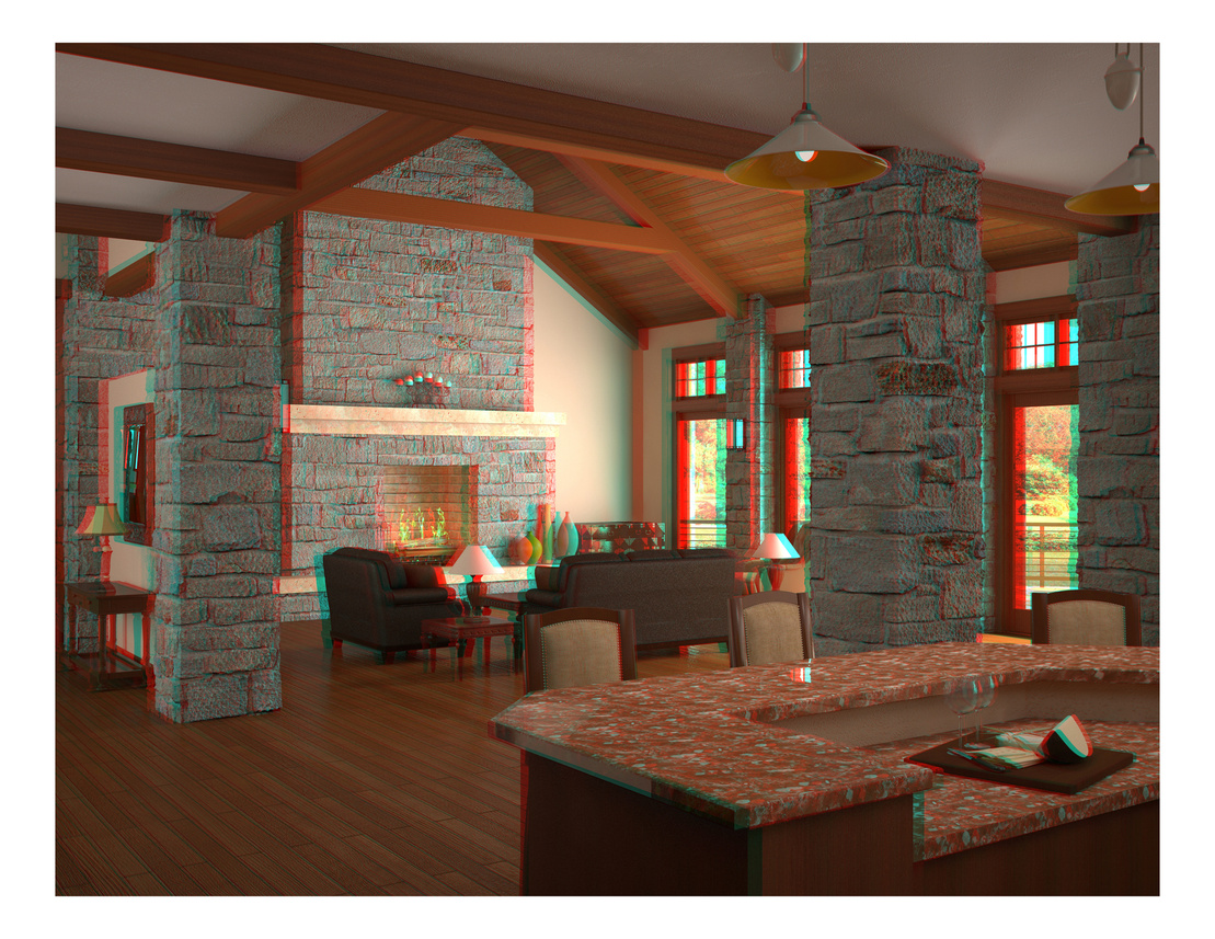

    here is a quick Stereoscopic render of a great room I am working on.

          is this supposed to be looked at using red/blue anaglyph glasses?

            yes, at least that is what I have.

              hmm..you might need to adjust your offset or something, I'm still seeing alot of red and blue. they should converge and kind of cancel each other out to a degree.

                When you Finish Bobby mind just commenting on the steps you took to create the image. I went back to the ster. camera post and it seems a little confusing to me.
                Ok: so i installed the plugin, and i see you were confused about the helper as well. Do you just move it and render move it and render since you cant see it like the camera. Hoping to get the view right lol. How about Camera Exposure etc. Not sure how this works.

                  If the helper is in our scene it'll work when you go to any vray camera. You place the helper at any location and it only takes one helper for all your camera.
                  Mine was done with a camera rig so I wasn't using the vray plug-in.
                  I placed the rig and script on my site:
                  www.nor-son.com/planroom
                  Scroll until you see the 3D Stereoscopic folder and use "vray" as the password (no username)

                    Dont know wich rig u used. I recently used one of the freely available stereo rigs that seemed pretty nice and did a little trick by wiring the Convergence to the vray helper and rendering from the center cam (the rig has both left, right AND center cam)
                    So all the preview functions, fun stuff of the rig works, and when done, just render from the center cam with the vray helper

                        just drop the helper in and hit render from any camera.

                            Quick question, when i drop it in and hit render it changes the camera angle (ill post screenshot tomm). I left everything at default. When i hit the Adjust resolution it does the same thing i cant seem to get the image showing correct.

                              I think that is a bug. An earlier post mentions that.
