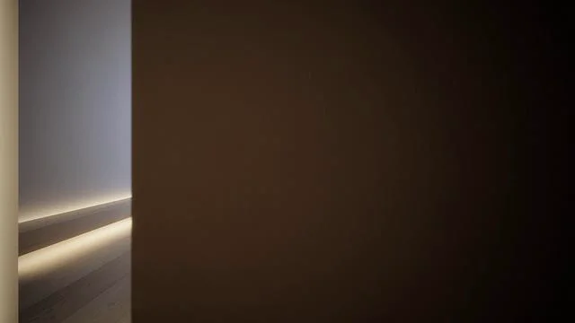

    A quick lighting study, inspired by John Pawson's Plain Space exhibition at the design museum in London (its still on I believe, I haven't been over to see it though sadly)
    The main floor texture came directly from dinesen (I can't share it, sorry), both timber floors are made using brix, which has become indispensable for things like this. Rendered as always with Vlado's universal method, and the final images are pretty much as they came out the vrayFB. I added the slight glows to the lights in photoshop, unfortunately vray 2 beta 2 wasn't out when I rendered them!

    Great images peter,
    The 8th one is my favourite, just a couple of questions, what type of light are you using on ceeling lamps, maybe ies(?) and what are your average render time(?).

      Really nice stuff. Your control of the light is top notch.

        Excellent imagery Peter. Nice one !

          vrayies for the spots, with a color temp of 4000k. The lights under the benches are vraylights set to rectangular and with a color temp of 4000k again. The outsude lighting is a vraylight set to dome with my 1224 hdri sky. For the lights at the door, i cheated a bit and just put invisible rect lights facing the wall, it gave the same effect as a translucent panel (see attachment).
          Each render took about an hour, but then there were 3 workstations working away using DR! For things like this, I usually don't bother spending any time trying to optimize irradiance maps etc. I just let it render overnight and try to mentally move on to the next project!

                  Good renders and always. Your render style fits to John Pawson`s architecture
                  Can you say something more about your clear AA and GI settings and time of renders ?

                      very serious piece of work, as usual I must add

                          Thinking about trying a little movie of this space, need to plan out some camera moves though, and try and find a point for it!
                          and if anyone has any cool ideas please do share, i'm out of my depth when it comes to animation. I was thinking about playing about with the lighting, and some simple short camera movements.

                          • #14
                            Looking foward to watch that!
                            How much time per frame atm and which res will you go?
                            How about making some artificial light go off and on in some particular moments? That would be cool imo!
                            Good luck

                            • #15
                              thanks for the ideas, i was thinking along those lines too, maybe a sort of timelapse effect too, going from day to night and then turning the artificial lights off at the end. Been done before, but you have to start somewhere!
                              That little test was 1280x720 and between 2 and 5 mins per frame.
