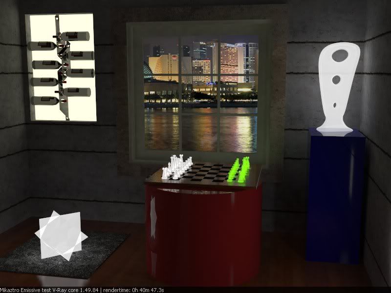

                  Here are the settings for the following images above:
                  CHESSBOARD:
                  Global switches - Lights, default light, hidden lights, shadows(ON). Show GI only (off)
                  Camera - Default camera(on), Physical camera(off), Depth of field(off)
                  Output - 800x600
                  Environment - GI & Background(off)
                  QMC Sampler - Adaptive amount(0.9), Min samples(8 ),Noise Threshold(0.01), Subdv Multi(1)
                  Displacement - Edge Length(4), Max subdv(1000), Amount(1)
                  Indirect Illumination - GI(on), Reflect Caustics & Refreact Caustics(on)
                  Primary engine - IR map
                  Secondary engine - LC
                  IR MAP - HSph(40), Samples(25)
                  Caustics(off)
                  Materials:
                  Statue - color(white), intensity(3), transparency(218, 218, 21, reflection glossiness(.85).
                  Neon green - color(128, 255, 0), intensity(2), trasparency(197, 197, 197), reflection glossiness(1, 1),

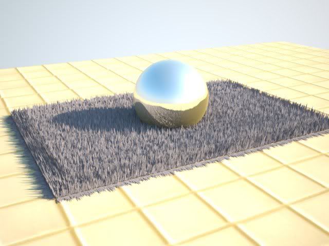

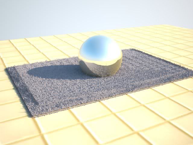

                  GRASS TEST
                  Render Options:
                  Physical Camera(on), SS(60), FS(500), F#(11)
                  Environment(on)
                  Displacement- Edge Length(20, Max Subdivs(1000)
                  Indirect Illumination(on)
                  Engine - IR + LC
                  Caustics (off)
                  Material Editor:
                  Chrome ball - Chrome shinny vismat
                  Grass carpet - diffuse map, displacement (bermuda(1)), (talahib(6)), (gulfball(3))

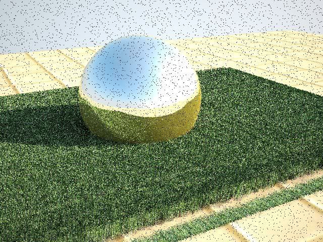

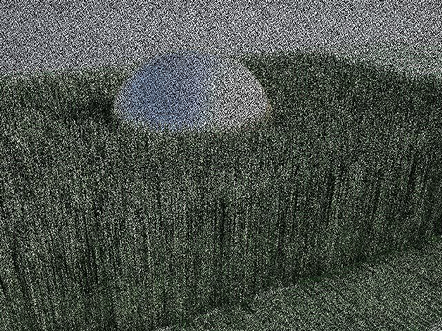

                  GULFBALL TEST:
                  Render options
                  Camera options - Physical camera(off)
                  Environment(off)
                  QMC sampler - adaptive amount(0.9)
                  Engines - IR + LC
                  Displacement - edge lenght (2.5),Max subdv(1000)
                  Indirect Illumination(on), refract caustics(off)
                  Caustics(off)

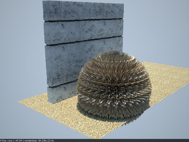

                  FURBALL
                  concrete wall - displacement(1.5) with displacement map and diffuse map.
                  Furball - displacement(2), with diffuse and displacement map inverted.
