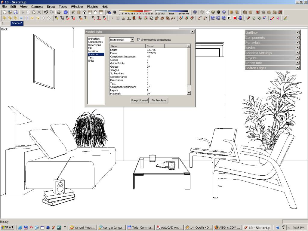

    this one is the biggest model so far, and it's 139 MB.
    i don't have problems with navigating in the model.
    i actually have smaller ones(50 MB) but with a lot more textures, in which navigating is difficult.
    so here's the skp view.
