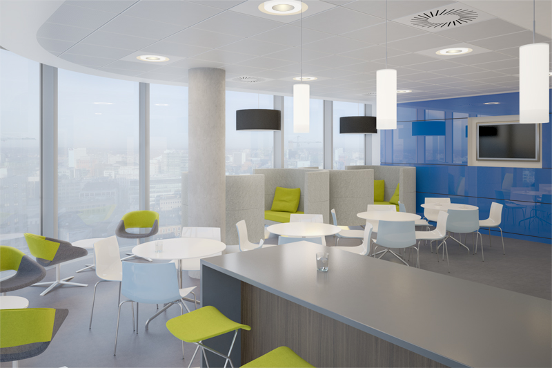

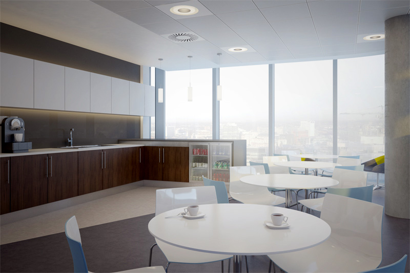

            Here's the reults of my latest efforts. I've tried a few new things here - HDRI instead of Vray sun and sky, an AO pass as well as detail enhancement (still very much need to get to grips with the settings of the latter to avoid massive render times) and no white lights! I've also put a bit more time in to the post-production side. If anyone's got the time to comment I'd appreciate it. I think it an improvement to my previous post but have I been too subtle with the AO and light colour variations?

              Hi there, it is getting better, nice quality overall, but there still a couple of point that maybe improve. I feel the white maybe a little too white again but we can feel it more with the slight coloration in your lights, I'm not sure about the glass, seems semi-opaque maybe its wanted I dont know but if its not hope your glass diffuse color is completely black ( and this impact on render time, glass color between white and black) It looks like we could fell more of the exterior but its hidden behind the glass, for the lamp shade play with the vray2side material with translucent to get a nice shade effect and not full blast, the overall glow effect is abit overkill for my taste, my 2 cents in a constructive way, hope it help!

                I did knock back the background image but possibly too much to be realistic, although I've just checked my glass material and the diffuse is white not black so I'll be changing that, oops! Client's comments were that it all looked a bit 'grey' - thought this was down to the scheme design but actually if I increase the contrast (significantly) in photoshop the colours punch out a lot more. Now I just need to figure out how to do this in max with the lighting rather than having to achieve it in post :S

                • #23
                  Very nice. Good improvement. In the first image of the 2, I'd like to see more contrast, it's lacking anything below 30% Gray, check PS levels for verification.

                  Here is the 30s edit I did pulling the levels in so you get a more full gamut of darks and lights, and a simple vignette through PS'ed Lens Correction tool and some slight color adjustments.
