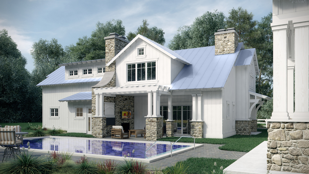

    Okay, got some finals.

      Looks great! Just one minor thing I noticed - looks like your siding has sharp reflections. Maybe you forgot to turn glossy down after prepass?
      • #18
        That was a last minute thing. I wanted to get a slight blur reflection, but it needs some work.

          I think the pool is too glassy, maybe turn down reflections or work on the noise map.
          Something I notice in many of your pictures, and I believe I've mentioned it, is that your stone columns have very sharp edges and is for me a dead give away. There is also something about the stone texture that is either to saturated or too bright, but both your images are soo good otherwise that these stone textures to me really stand out as 3D.
          While I'm at it I also feel those chrome handles in the pool are a bit too polished.
          • #20
            I need to start chamfering my stone columns, or something. I will on the next one. Usually on the stone, I match a photo.
              max 2015 extension 1 has opensubdiv, perfect for this sort of thing

                i'll check it out
