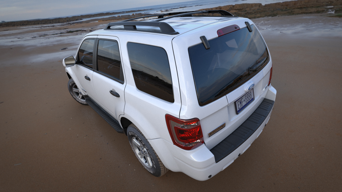

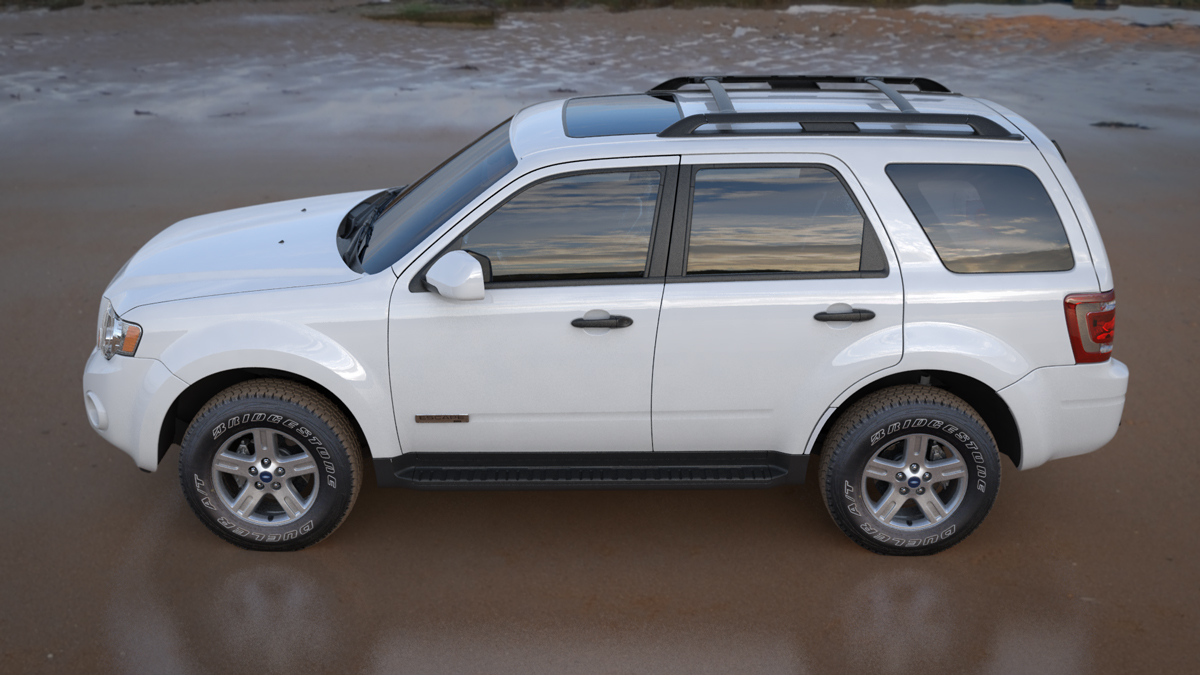

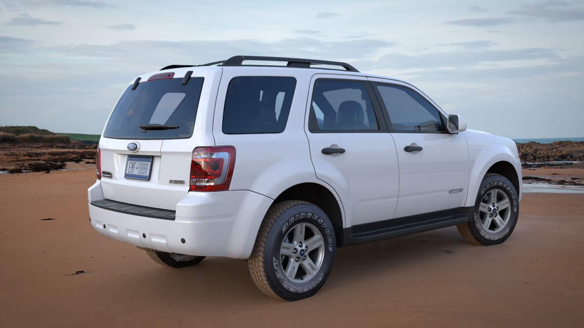

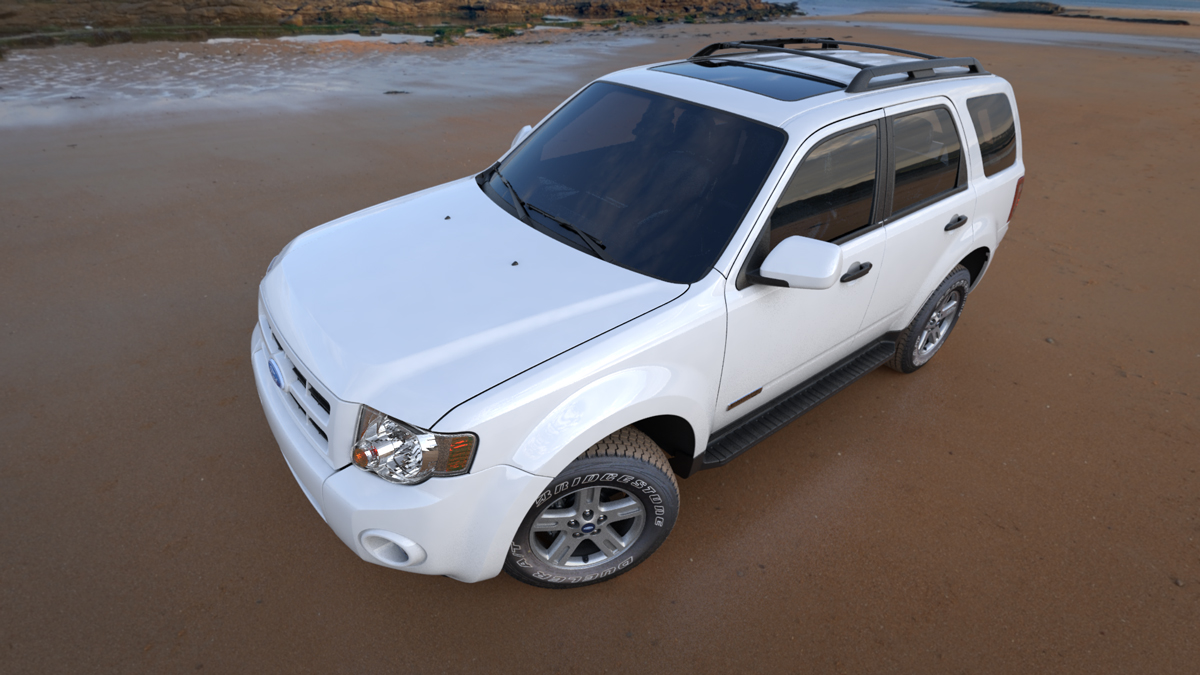

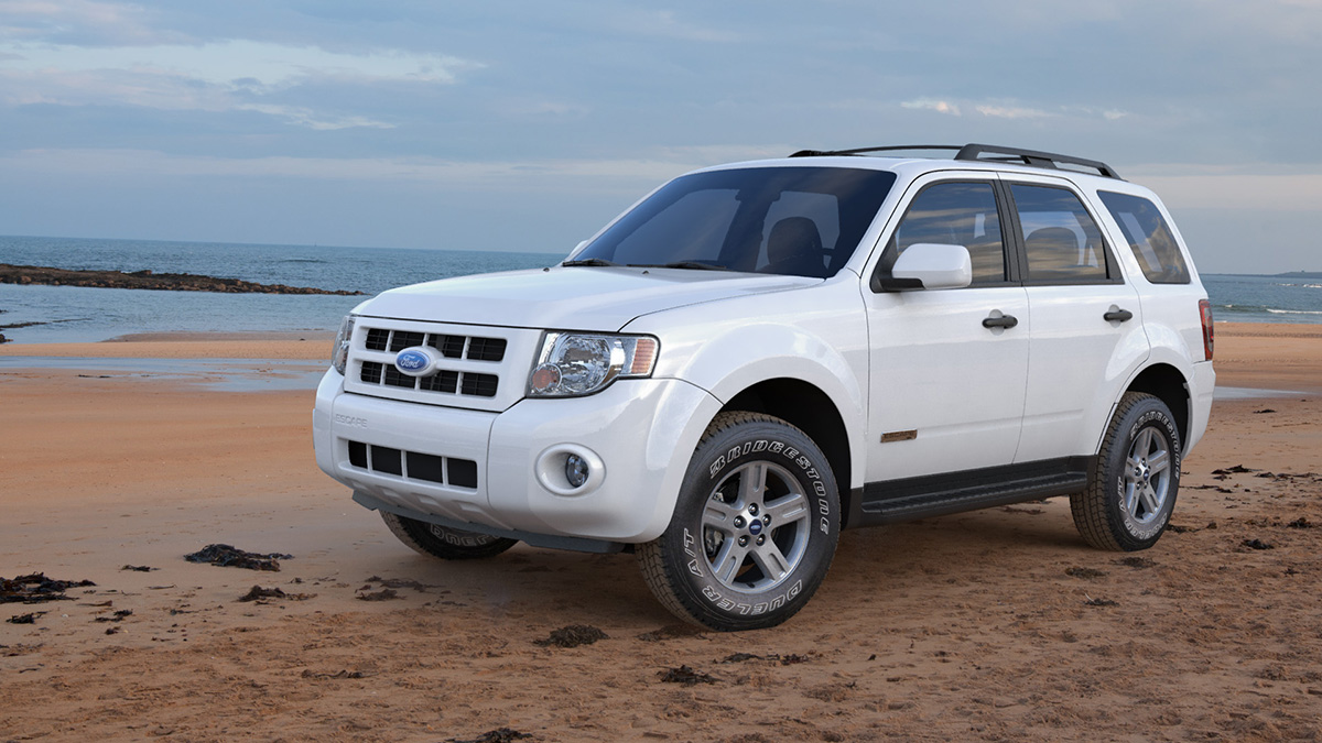

    Hi There,
    Just thought I'd share some tests I've been doing with Modo/Vray.
    Hope you enjoy
    All the best
    Stuart
    Very nice!
      Testing your camera? Looks 100% real to me! Maybe some tracks in the sand.

        Cheers guys,
        Yes I think I definitely need to add some tracks in there! it would help bind it into the BP a bit better for sure.
        All the best
        Stuart
          Nice! Looks photoreal indeed.
