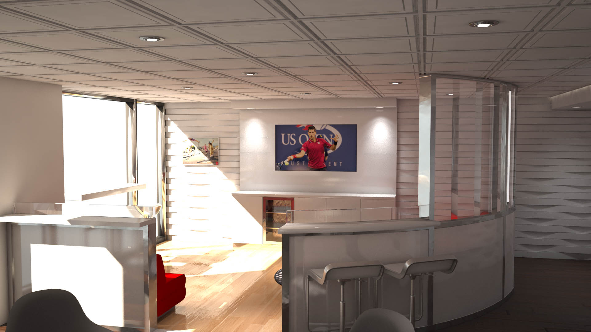

    Comments and crits are welcomed.

    try a vray light plane behind the glass, invisible and affect reflexion off... if you have vray sun, multiply the size so your shadows are not that sharp. I would start playing with the light behind the glass as the only source of environmental light for now.( no vraysun)

      Thanks for the tips. I will try that out today.

        Balancing light for interiors is a struggle. Try rendering out linear and save as a 32bit EXR. In PS use the Camera Raw filter to balance it. A lot of the times the auto works for most. From there, you can tweak things.
          Question for you inregards to EXR's. How do I get my render elements to show up in PS? Do I need a plugin for that?

            ProEXR and FXArion open elements

              It opens natively, for me.

                [QUOTE=glorybound;653704]It opens natively, for me.[/QUOT
                Weird I can open the exrs in PS I just cant see my render elements show up. My office got me the FXArion plugin. So now I can open exr with the render elements. I played with the RAW fliter, very nice tweaks. My only issue is when I do a save as and choose tiff it saves it different them what I see in PS. Do you need to convert it to 16 bit?

                  you'll have to open each EXR. I use PSD Manager, which brings everything in together.
