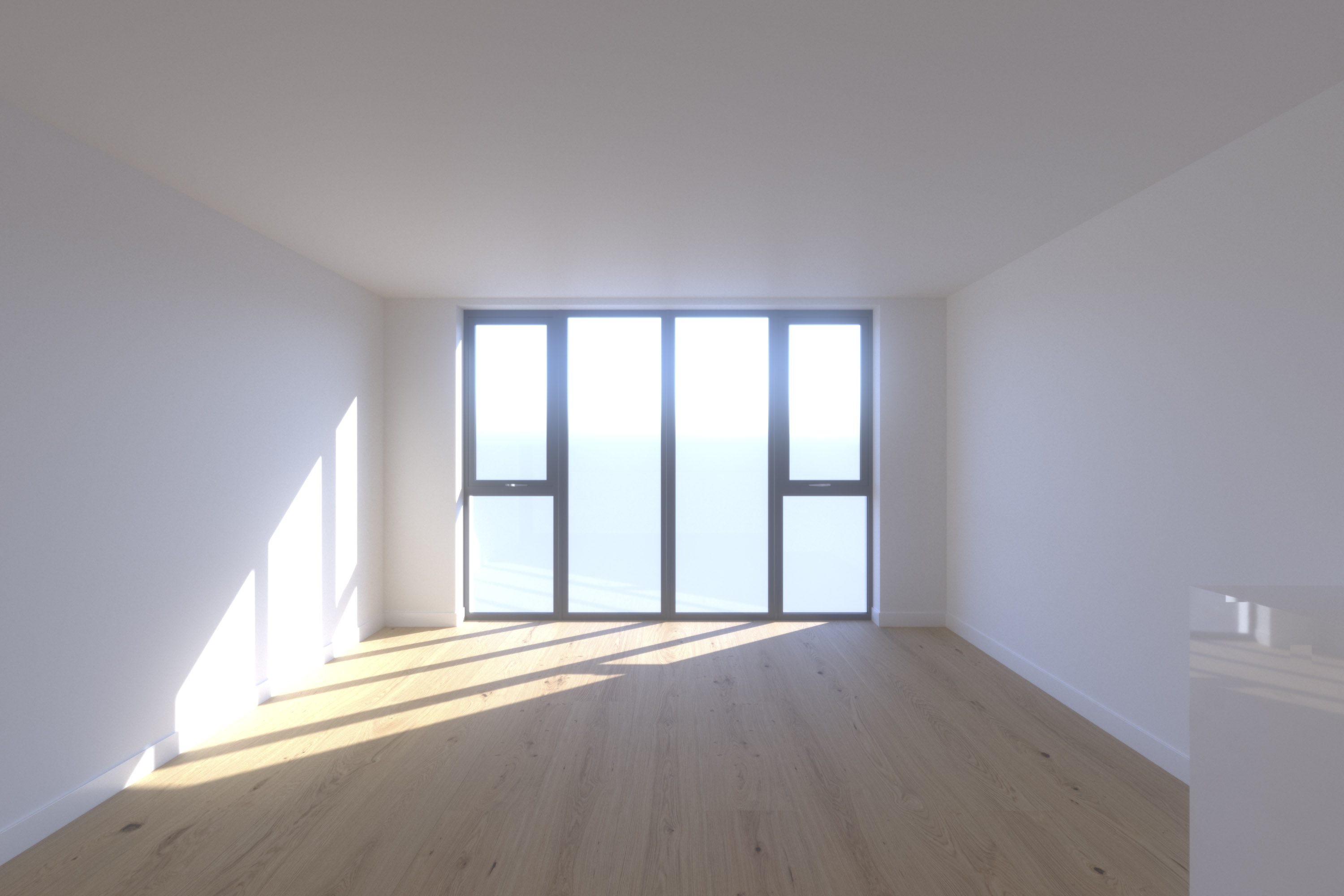

                  These are the first two shots that I took to get the general exposure balance (and sign off on camera position).
                  As you can see the highlights are really over-exposed, but the rest of the room looks more or less correct - it's also at this point I sort out white balance to take into account the colour bleed from the floor. Don't be put off by the apparent lack of contrast either, as long as you've exposed to include as much pixel information as possible then the rest can be adjusted in Lightroom/Camera Raw/Photoshop. After this I spend some time populating all the main parts of the scene before deciding what to do with the lighting. In both situations I found that once I'd placed a number of items of furniture the shot began to look very cluttered because of the strong shadows cast by the window frames - these needed softening, which was a simple case of increasing the suns size multiplier to 10...
                  The downside of this is that those over-exposed highlights grew larger, which led me to ask this question: http://forums.chaosgroup.com/showthr...ySun-Sky-ratio
                  So I went with the tip there and used a separate sun/sky and specified the existing sun in my scene as the sun node - this way I could independently control the amount of light coming from the sun/sky. I ended up with just reducing the sun multiplier to ~ 0.5 - though it is worth noting this will throw your white balance off just a little, as there will be a higher proportion of blue light from the sky.
                  Hope this helps.
