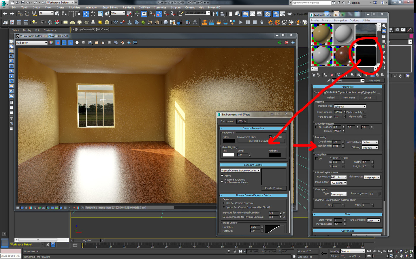

              • #22
                So I can package my scene but I just applied an HDRI to the v-ray dome light then made it invisible in the light settings, made a copy of the vrayHDRI and droped that in to the environment BG and then on that one in the ME I adjust the Render Multiplier as the Overall seems to have no effect and I can drop it down to get it to expose anyway I want for the BG without affecting the light of the scene.
                the scene and materials are a little crude as this is just to demonstrate the lighting and the window is open on purpose to show the glass is not affecting it.

                    • #25
                      .01 was the key. I didn't try lowering it that much.

                      • #26
                        Yea on some things Ive hit some crazy numbers like 0.001 and lower lol. Glad its working for you now
