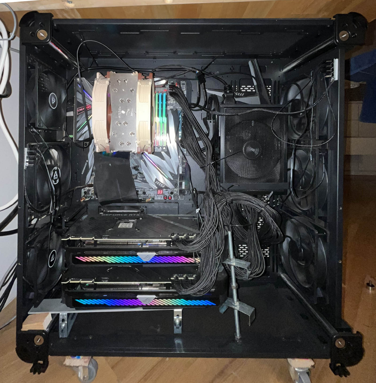

        ....progress so far, that was actually quite easy to setup and very cheap, the construction is very light. But still nothing to put inside;(

                      it is my design, but first inspiration came from your rig photo It is not precise, not 100% right angles and finally more holes that I need, coz during the adding the parts I realized there is need for more clearance for the cables. But works ok so far and when the fabric get dusty I can wash it...

                        last parts added,
                        -RAM at 4400 for 100% stability (can go a bit up probably), AI OC set from performance to optimized, all is very stable
                        -GPU finally OC GS version arrived (ordered non OC...), not enough PCIE cables from PSU so each GPU use one PCIE double split cable and rest is normal
                        -running all 3 GPUs the system wattage never go above 1100w (approx 1hr rendering)
                        -all temperatures 60-65 during the long load
                        -vray benchmarks little above average
                        hope no more problems and crashes and hope this is end of the story - thanks for the help!
