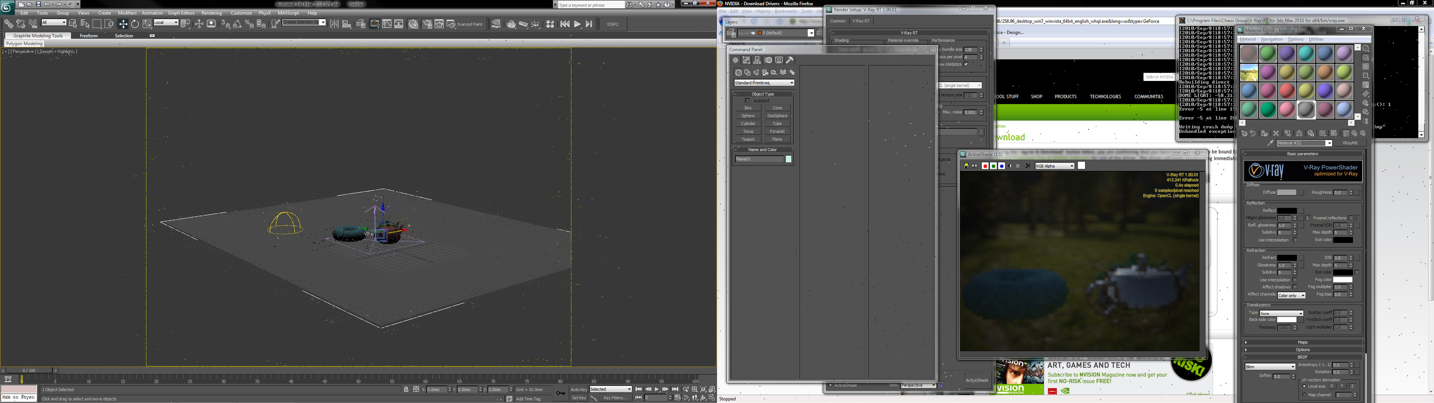

    Whilst using RT for Gpu, the screen begins to flicker after about 3min. The flickering does not stop until I restart. I am using a Quadro Fx 580 with latest drivers.
    See image attached.

    The -5 error in the RT render server window means that the OpenCL driver has run out of resources. Can you show me the rest of the console window (where it says the line numbers)? You can try reducing the ray bundle size/rays per pixel a bit and see if it helps.
    Vlado
      I will try to get the whole console window next time. I tried reducing the Ray Bundle size and rays per pixel. 128 and 16 respectively seems to work well.
      I think my graphics card is too underpowered to run dual monitor and vray rt gpu. I am trying to distrubute to another two machines with little success. Is vray rt gpu able to distribute the work load to other machines?
