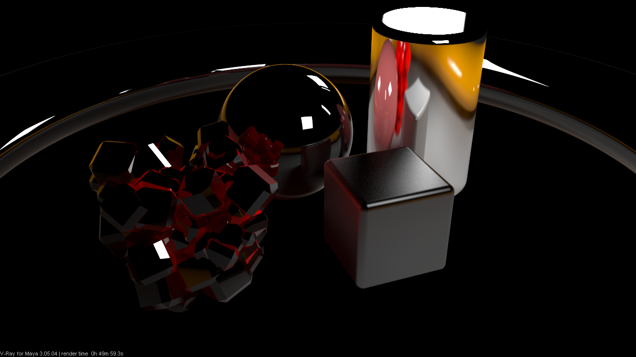

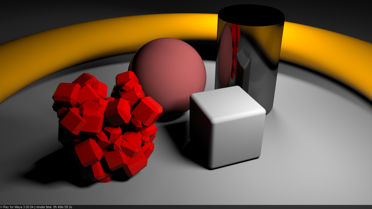

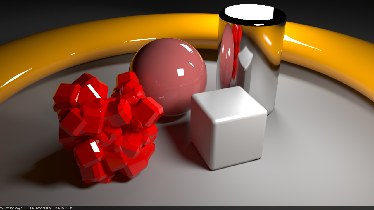

            Here is one of my test scenes and this time the reflect/specular channels are far noisier. Is there anything one can do except letting it render longer? Rendered with GTX 780 6GB, render time: 49min59sec.

              Close Maya, set environment variable VRAY_RT_GPU_RECURSIVE_BLEND=1, start Maya again and see if it is any better.
              (if you have done this correctly, in the vray.exe command line log there should be line "Using brute force for blend mtl" and the reflection pass should become a lot clearer much faster)
              As I said before, keep in mind that this is a bit "experimental" and "not official" feature

                I tried RECURSIVE_BLEND=1 and it helps a lot! The reflect pass was smoother after 10min of rendering than a 2h render with RECURSIVE_BLEND=0. And the best thing is that I didn't notice any increase in noise in the GI pass. Thank you very much! This feature should definitely become official .
