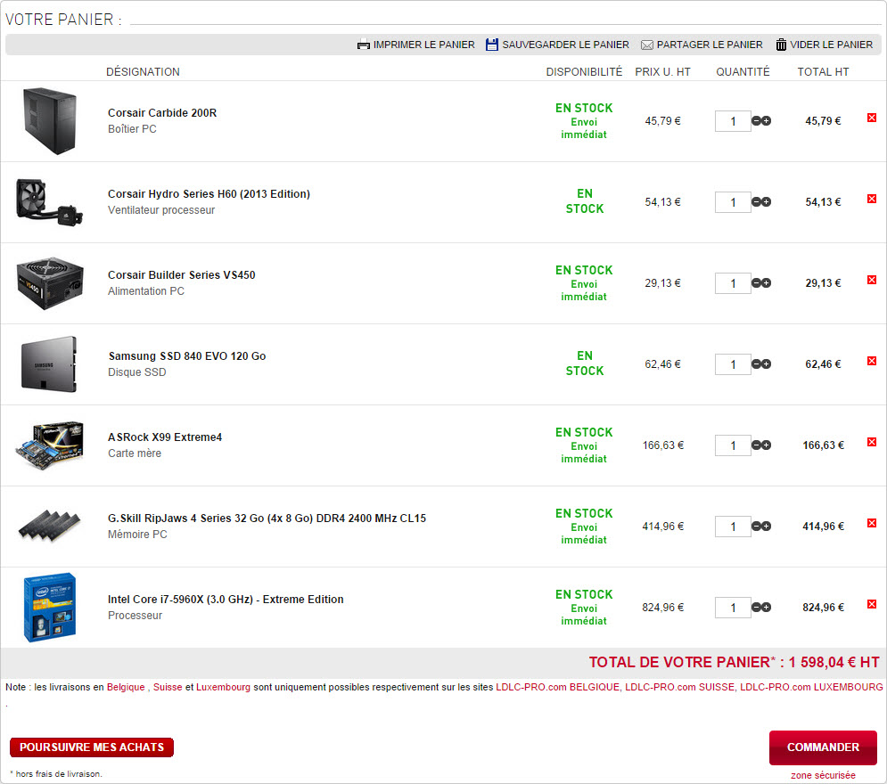

              • The blades I found on ebay cost €12k. They do not have any hard drive so adding 16 ssd ads up €1k. So €13k all summed up.
              • The 5960x rig that I just put up could be something like this :
              Total of €1600 by 10 so €16k. It's a difference of €3k.
              To be completely honest, I should go for only 8 of those 5960k in stead of those 16 blades. And even OCed, I don't think 8 of those 5960x will make up the 16 baldes.
              You're right, might not be the same price, but I'm just guessing the power drain and the ease of changing anything that breaks makes the i7 still more attractive.
