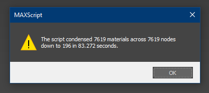

                              Oh Lele, thank you so much! I had to spend days in the past for this!
