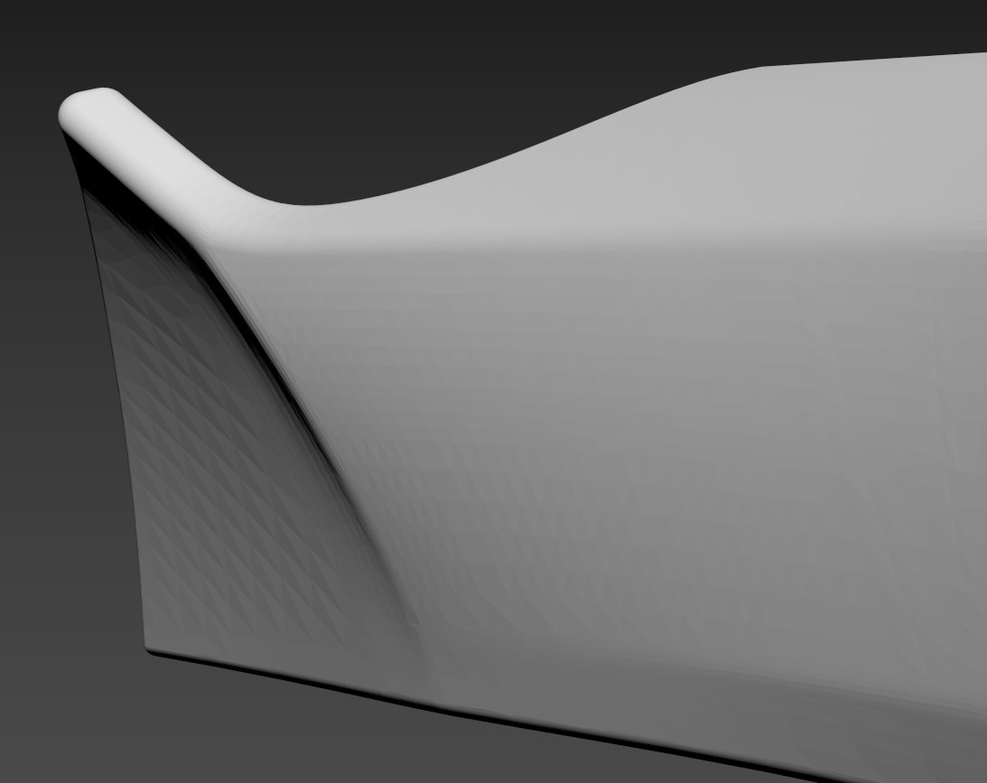

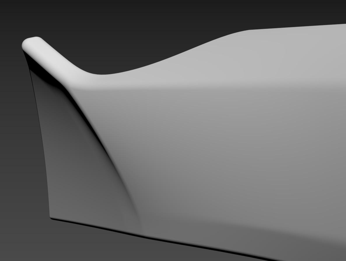

          Regarding the edit poly versus convert to poly: No, it is not the same. Edit poly modifier on top of imported Edit mesh breaks normals, convert to poly preserves them. Take a look at the images:
          Convert to Editable Poly:
          Edit Poly modifier on top of Edit Mesh:

              No. This script is working on the whole objects, not just individual polygons. And no, it is not the same as adding a normal modifier. As shown in the screenshot, adding a normal modifier in CAD-data originating from Nurbs will break normals. The script does not, and that is the whole point.
