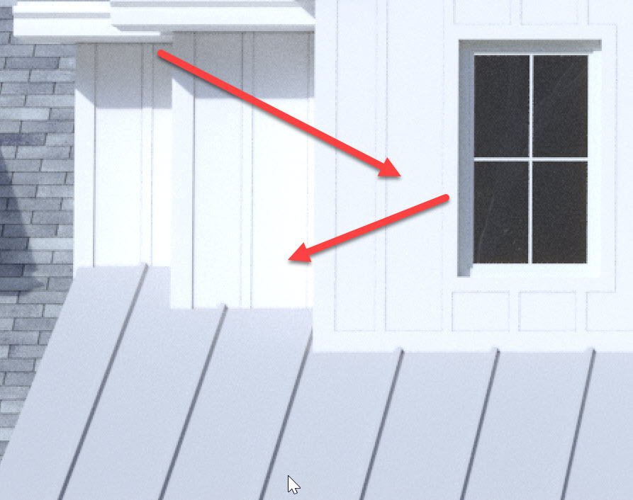

    I am having a heck of a time with white exterior paint. I can drive down the road, on a sunny day, and white paint is white and you see all the detail. In VRay, I have tried all the tricks and my white is blown out. If I go any lower in color things look gray. I have tried the color mapping tricks and the VRay frame buffer highlight burn. What's the trick? I am having some luck with a dirt map in the diffused, but not much.

                              My white's suck! This is white with no reflection or specular. One plane is gray and one plane white.
