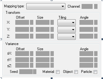

                      I think I'll replace the coordinates rollouts in all my maps with this: http://www.ylilammi.com/graphics/Mapping_03.jpg

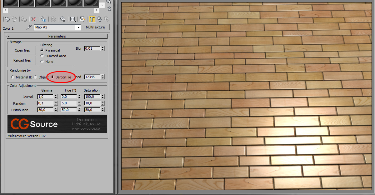

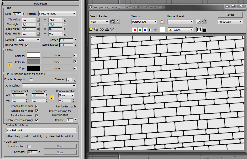

                            I ended up doing a complete rewrite for the tile map, here is how it looks like now. Also added support to use MultiTexture to distribute random bitmaps for each tile.
                            Menu (still messed up but you get the idea) http://www.ylilammi.com/graphics/TileX_05.jpg
                            Diffuse + Displacement and some random variation on tile sizes: http://www.ylilammi.com/graphics/TileX_06.jpg

                              I'm just wondering, can you set UVW parameters for the MultiTexture bitmaps, including real world map size?
                              I guess you can't use the default bitmap loader/map slot, because it can load multiple bitmaps at once?
