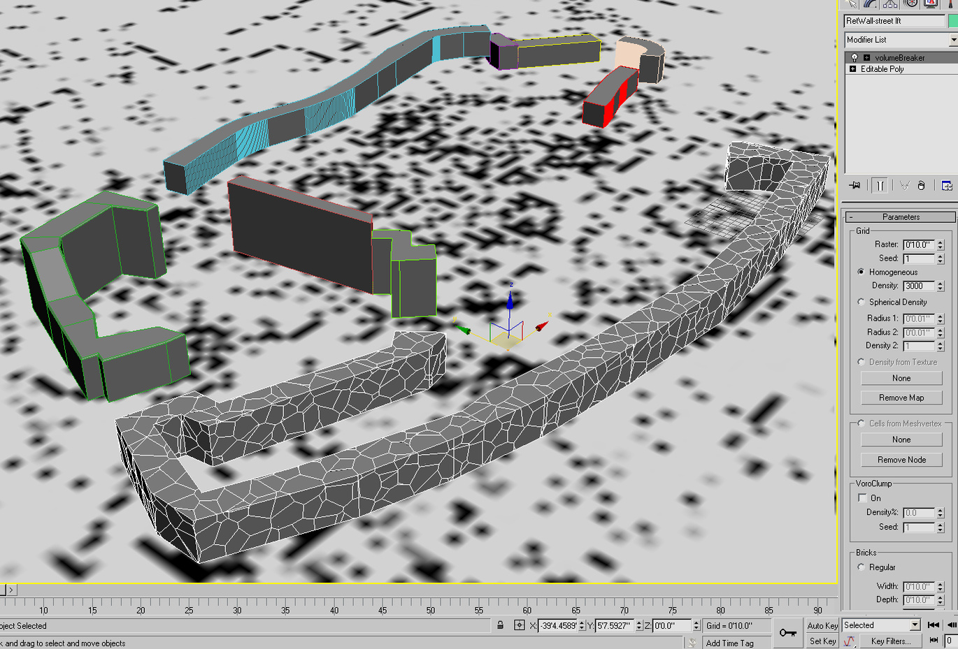

        Okay, I want to state that at first, I started with simple primitives and some extruded shapes, some "L" shapes and "U" shapes, I don't think that mattered.
        They were low poly to begin.
        -Next I added the VB modifier
        -Then, after some trial, crash, error, and tip from developer, I added turbosmooth mod, 1 iteration. Seems without this, the vb shows the cut lines, but the object is not broken yet.
        -now go back to the VB mod and adjust settings
        -For the grid, I used "homogeneous."
        -now is where a lot of tests come into play
        Try to mess around with the homogeneous density and the raster values the most. These are in the grid part of the roll-out. I tried about all the stuff in the roll-out, but for now, these are the key players.
        depending on your scene, end result, material technique, the rest may vary.
        First, I chose 36 stone bitmaps that looked close enough to the existing walls I wanted to represent. (Some required downsizing.)
        I made a folder for them and renamed them as "stone01D", "stone02D", etc....this part was the most tedious part of making all 25-27 of these walls
        Then, I chose to go with a MaterialByElement mod set to....36, random distribution
        -back to the VB mod roll-out
        -look for the options area of it
        -set MaterialID to match your number of stone bitmaps, for me it was 36
        -Map Type = Box
        -I won't go into all the steps, but now make a material using all the stone maps and apply it to the wall, apply a box type uvw mapping mod.
        So, in the end, I have a stack in this order
        1-VolumeBreaker
        2-Turbosmooth
        3-MaterialByElement
        4-UVWMapping
        After this, copy and paste the stack to other walls if you need more than 1.
        I did this and each time mess with the volumbreaker and materialbyelement seeds to keep variation
        And, for some walls, I ended up adding optimize and/or subdivide mods beneath the VB mod. This was mostly because the scene was getting heavy, and from the camera distances, it didn't seem to have much ill affect.
        Well, I hope this can help someone like it did for me. I got this project and the deadline was just shy of 2 weeks away, for (2) 24"x36" prints. I work alone and thought I could never make all those walls alone in the alloted time so I looked around for anything that would help. I found a few things, but this one seemed like the best bet. The learning curve was all of 6 hours, maybe less. Actually, the material part really was the worst part for me, just so tedious. I got my walls and site base finished in a day and a half thanks to this plug-in and the client loved it and stated amazement. I must admit, I really regreted the purchase after the first hour, but now I look forward to my next project where I get to use it.
        Sorry for the delayed response, I've been hunting big varmint in my gardens...
        Thanks
        edit, here is a screen during creation...
Name:	swalls setup1.jpg
