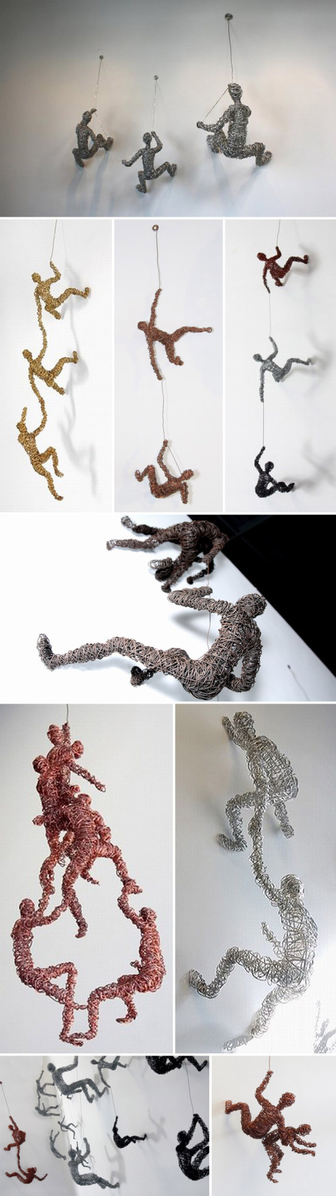

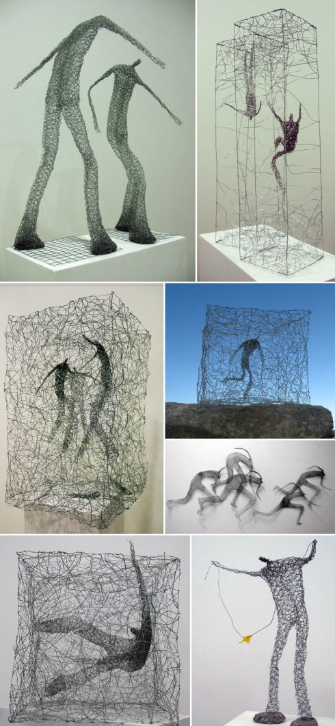

    Does any body have an idea how to model something like this:
ID:	877801Click image for larger version
    You somehow need to fill a volume with lost of spaghetti squiggles.
    Wim
    I read a tutorial a while ago about doing this with particles. Will see if I can dig it out.
