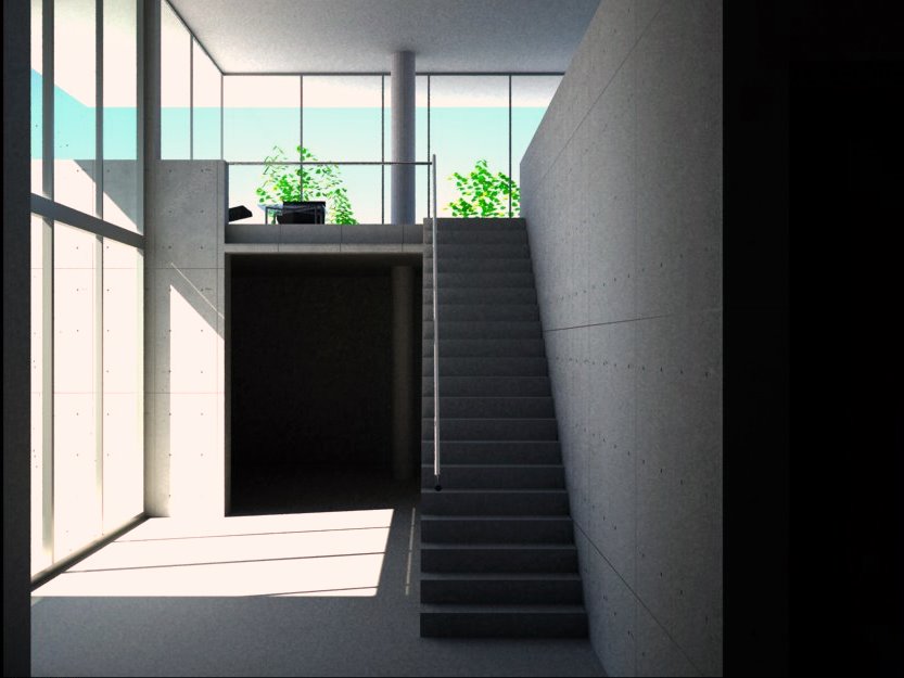

    I'm having a problem of setting up a concrete material that should have blurry reflection and proper textured.
    I uses 0.01 of Displacement map for bump
    0.7 of Glossiness with Fresnel map of 4 IOR
    is there any possible way of improving it?
    Its rendered with IM 5 passes + LC 5000sub
    thank you so much

    First I think you're using too high options settings (if this is the resolution and some). Displacement is not necessary, in this case you can get away easy with just a bump map.
    What is the Highlight/reflection glossiness? or are they both 0.7?
    There are all kind of concrete textures/finishes, so please post a reference image of the concrete you want to produce.
