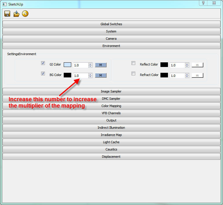

          I have a question..where I can increase multiper of image?in camera settings?if I increase it rendering time will increase,am I right?
          Outside the texture editor and between the BG color and the "M" you will find the multiplier.

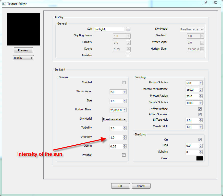

            I have another question..In my renders skys light are too much and they will become too light how that I can decrease light
            I usually use the physical camera parameters (Shutter Speed, F-Number or Film speed) to control the exposure of the sun, but if you want you can also reduce or increase the intensity of the sun inside the sun options.

              But I cant see your images..can you please upload them in a image upload center?
              Thanks a lot for your help
                Hi
                Here are the images
