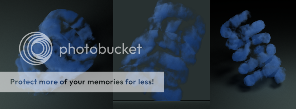

    Hi, i m trying to render poly object like volumetric cloud using VRayEnvironmentFog. Below is first test output, Currently it looks like 2D texture applied on surface not like volumetric as shown in documents.
    So how to do this ?? And share your tricks to render object like volume at rendertime.
    The trick like always is the lighting ... The other important thing for volumetrics is of course the density.

      What are the dimensions of the shape?

        dimensions = 5, 10, 5
        Density map is tricky
          I could be wrong, but....
          Check your remarcher settings.
          With a step of 1, you are only getting (at best) 5 texture samples through that geo.
          I would set your step size to 0.1-0.5 and see if that helps. You could also reduce your max steps to (furthest point of fog from camera distance) / (step size).
          Let me know how you get on.
          Patrick Macdonald
          Lighting TD : http://reformstudios.com Developer of "Mission Control", the spreadsheet editor for 3ds Max http://reformstudios.com/mission-control-for-3ds-max/
            The step is not much of an issue when you have adaptive sampler since you will get noise which will be resolved with more samples with different random seeds.
            V-Ray/PhoenixFD for Maya developer
              Do you mean that no raymarching occurs at all with the adaptive sampler?
              I'm basing my suggestions on the fading memory of a project a few years ago (so it's probably out of date now anyway), but I found taking this approach meant I could get a good result with fog without pushing my image/dmc sample rates to the moon.
              Patrick Macdonald
                No, you always need some form of ray marching with textures. I mean, putting even 4 for the sampler subdvisitions will produce 16 extra rays, which will clear even big steps. Sometimes, it really makes sense to unload the image sampler, but sometimes you can use it's adaptiveness, since our ray marching is not fully adaptive currently, i.e. it will make all the steps.
                If I remember correctly, you can use 1 subdiv in the env fog, and it will fully shade only one point probabilistically (but will still do ray marching to find it). This will make the fog fully adaptive. But of course it has its own overhead...
