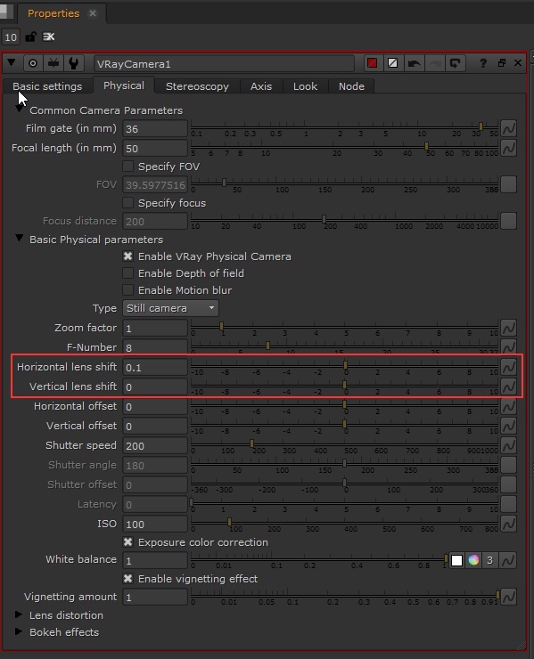

      Tilt/Shift parameters are available in the VRayCamera node here:

          Yes, the screenshot is for V-Ray camera, here it is again not as forum attachment:
          http://ftp.chaosgroup.com/support/sc...6_15-04-46.jpg
          I am not sure if Nuke's regular camera node support those features, might be better to refer to The Foundry's forums.
