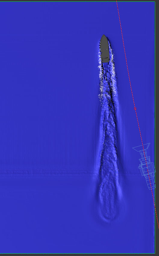

                    Ok I've managed to reduce the Sim size considerably now... Also changed the scene scale back to 1 and got more cells and animated the simulator to go up in Y to follow the boat but still have some weird stuff happening. The strict horizontal line you see is actually the simulator starting point. So he started there and when he goes up the liquid is at a lower level, leaving that edge there.

                      Is the simulator linked to the boat? Your resolution looks quite low from the screenshot - does it help if you increase it?

                        It isn't because the boat is animated to chop a little so I keyed the sim to follow the boat.
                        The problem was the simulator. It was bugged somehow, even moving him across the screen was a pain. It would barely move compared to any other geometry. I created a new sim and now is fine.
