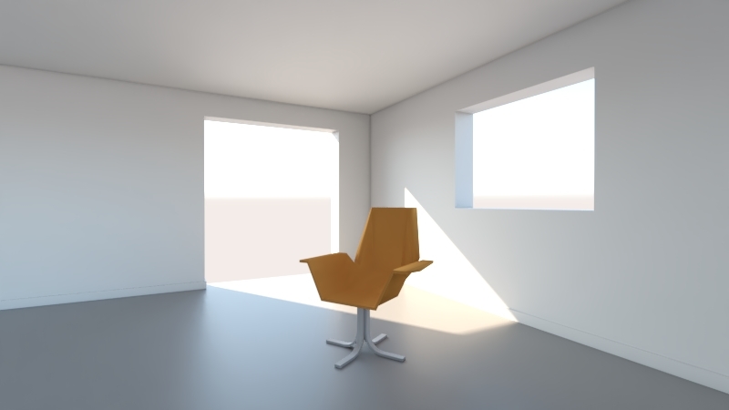

      Thanx for your reply peerman,
      I can't render your SKP; (don't know why it doesnt start)
        Here is my product on white floor + sun (20% rt)
        It's way better on a new scene, but I have so much difficulty on interior.
        Do you think I should download an interior directly?

            Note that you have to also configure Exposure Value under the Camera rollout, the default value of 12 is suitable for exteriors, for interiors you need to lower it to something like 5-7.

              My product start to look like real.
              I remade an entire room.
              I have a question, if you nerf the exposure from camera to 5-7: the interior start to look real, Im starting adding some spotlight, BUT: you cant see the exterior its to bright, you have a tips for this?
