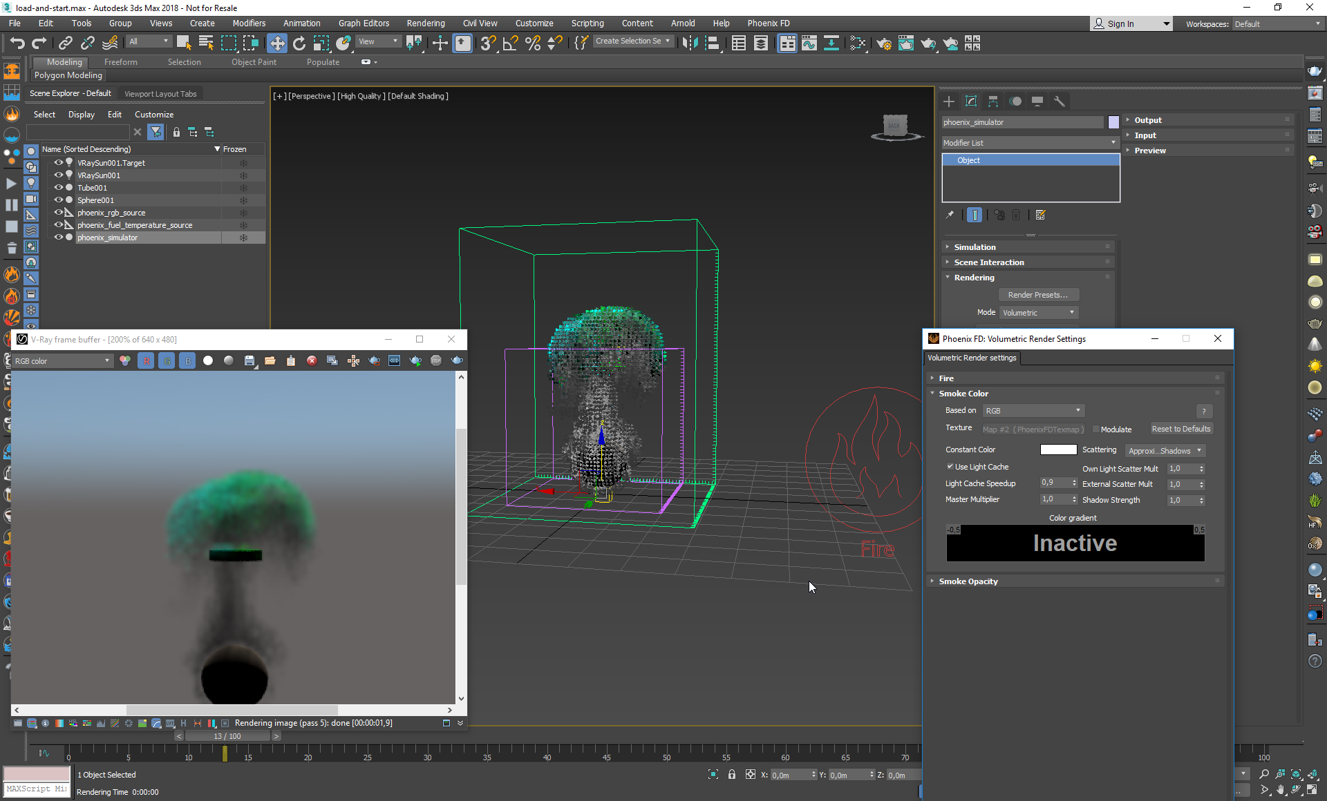

                I'm attaching a screenshot and the RGB scene just in case.
                load-and-start.zip

                  TomGore, here is what I'm doing to Load a frame from a smoke sim further down the timeline: load and start.zip Do your steps differ from the second Load where I pick the Backup Frame?
