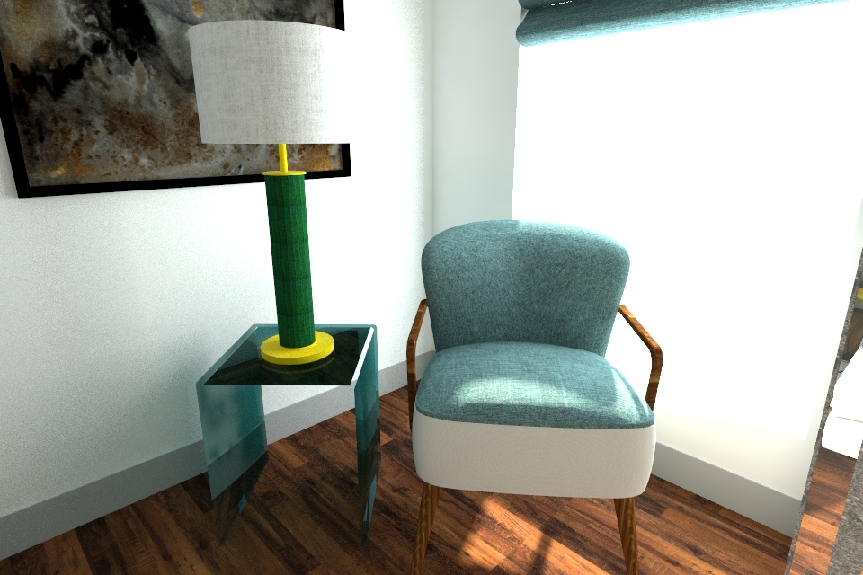

        Why my glass is not transparent? I used glass material from the library but it doesn't work. It just comes out black. I also tried using Sketchup Glass material but it also doesn't work. Does anyone know what the problem might be?
        I use Sketchup Pro 2018 and V-Ray 3.6.

          If you are referring to the table. Change the fog color of the glass to pure white and try again. Or lower the fog distance of the glass material.

            Thank you - changing the color of the fog fixed the issue, but why is the v-ray stock material needs this in order to work properly? I'm frustrated it didn't work out of the box.
            What about fog distance, where is this adjusted?
              I meant the Fog Multiplier, sorry You could lower it to 0.001 for instance. Also make sure that your glass is modeled with the correct realworld thickness. Another thing could be reversed normals.
