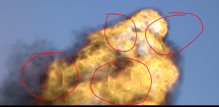

    I just learned how to render maya fluids and going trhouhg some experimentation.
    I rendered an animation, which it does finish without any problem, but i can see the renderBuckets in some frames.
    Is there a way to avoid that??
    I am using Vray 3.6 and Maya 2018
    Cheers,
    Tino

          Hi georgi,
          here is the scene file. I cannot upload the rar-file with the particle cache. If you could give me an Email. i could send you there a dropbox link or a wetransfer link.
          For the fluid I am just rendering the fire. I rendered the smoke separately but I get also this buckets.
          thanks for the help
          Cheers,
          Tino
            Hi,
            it seems that this is a known issue caused by the "Auto Resize" option. As a workaround you could turn off the "Auto resize". We do have it fixed in the nightlie builds and I'll let you know when the fix is in the stable builds so you could download and check it and see if this works for you. Sorry for the inconvenience.
