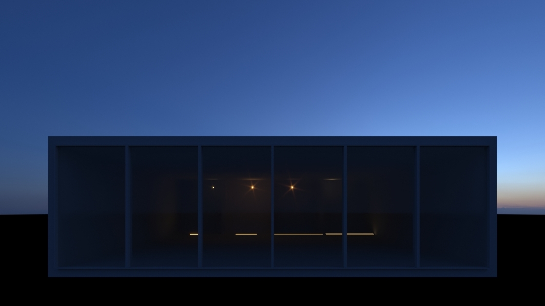

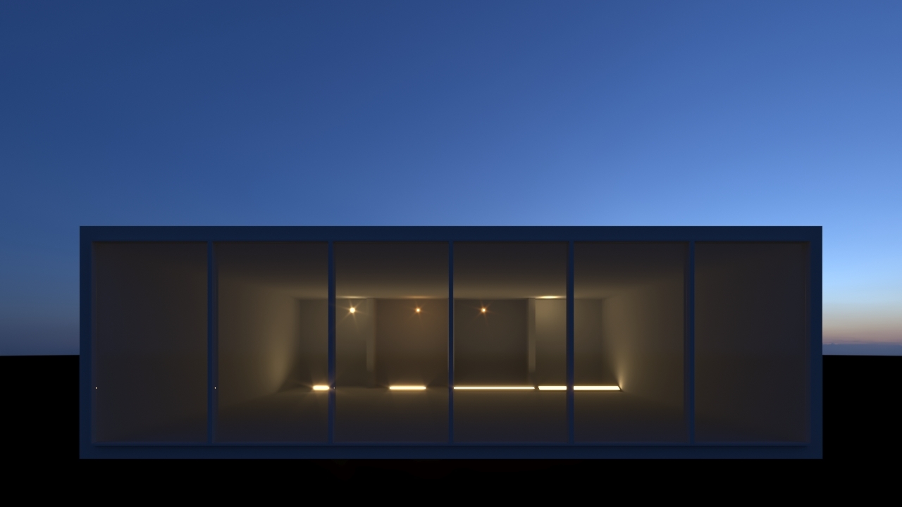

          During my experiments I came across this situation:
          one image has the hdr with the multiplier set to one while the other image has the hdr's intensity set to 16 (this is how it was set up by the guy in charge with setting up the library)
          As you can see the first image looks better than the second (at least for me).
          So after doing this I realized that all the images made with this dome were incorrect because the hdr didn't have the right exposure to start with.
