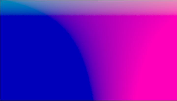

                  On the same topic, I'm still having issues with RSMB and vray velocity channels when using after effects.
                  I've attached an image of the velocity channel and the still. Then when I use RSMB with the velocity channel. I've followed the instructions on the link Thomes provided above by turning off linear light for the velocity. The result is odd and I'm not sure what to do now !
                  Both are screen snips and just for viewing. Can anyone help ?
                  The camera is quite low down and moving quite quickly across a water surface. It gradually pans up. At this stage it is low and moving quickly. Max displace in vray velocity showed to be around 175.
