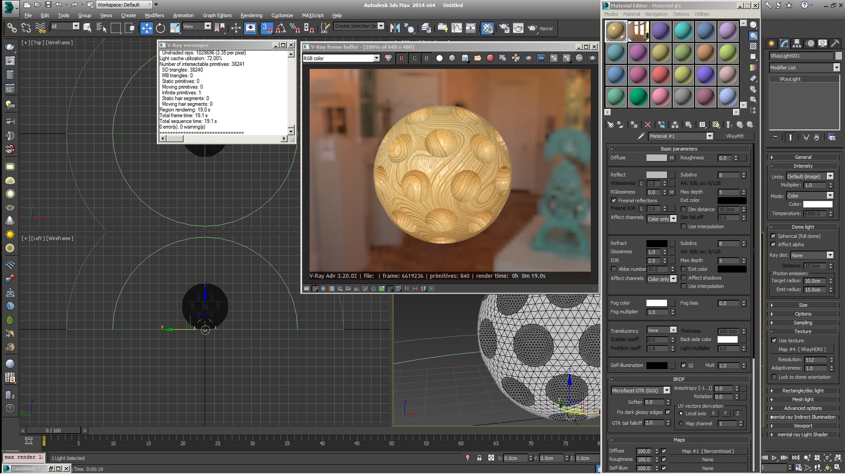

                A screenshot of the UI, with the render under lighting conditions (the dome settings are shown on the right. rest is at default.)

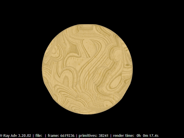

                While the render looks very uninteresting, that's the whole point of the exercise, as the render elements reveal (diffuse filter, reflection and specular, in order.):

                  Looks great, but I'm not sure to understand how this is any different process than loading a HDRI in a VrayDome and do the shaders as usual.
                  Am I missing something?

                                I'm sorry, this is probably a dumb question. But why does Lele's screenshot show a texture in the Vray Light if the procedure supposedly uses only a solid white light?
                                Is it that he toggles the texture on and off?
