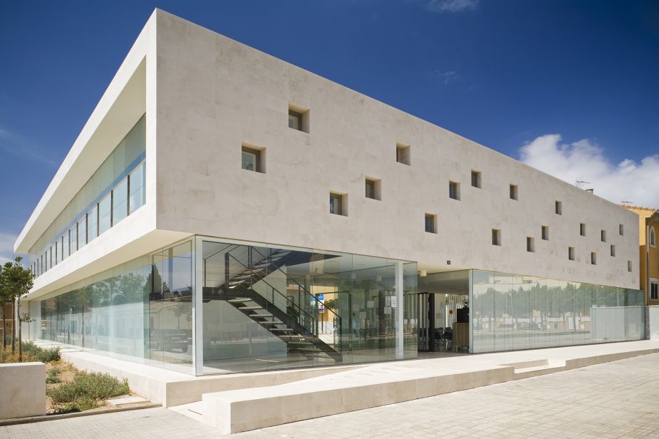

                  Originally posted by joconnell View Post
                  Yep!
                  In current shading models they consider when doing rough / microfacet surfaces they have an equation that just cuts out a portion of the light that gets trapped in the shadows of the rough surface whereas a lot of it would end up being directed into the surface itself and doing sss things! For something like chalk there's probably even a tiny amount of GI going on with light bouncing off the surface and then pinballing between some of the microfacets, giving it an almost glowy effect!
                  Here is an example of what I am thinking of. It seems visible in the sides that are indirectly illuminated
                  • #69
                    the exact term is retro-reflection, i believe.
                    you can achieve that easily with GTR, by lowering the gamma and gloss (without fresnel, nor the need for a diffuse.).

                    • #70
                      to clarify, do you mean basically:
                      -turn off fresnel reflections/any falloff map acting as fresnel etc
                      -set refract glossiness to something very low so that it 'spreads' over the whole material
                      -but then I'm not sure where the gamma part comes into it?? Sorry!
                      • #71
                        Correct for the first two.
                        Sorry for my misuse of terms.
                        I meant GTR lobe to tail ratio (just under the BRDF selection dropdown).
