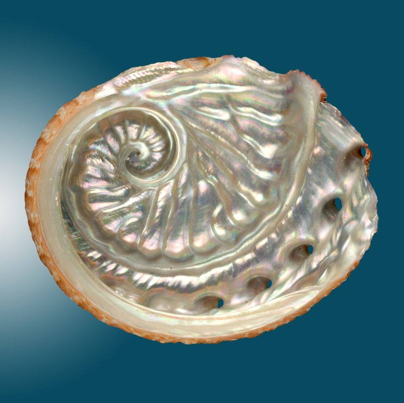

        thanks for the ideas.
        but I have some problems to get the effect. any other ideas?
        the problem is the gradient effect from pink to blue and from yellow to green.
        how would you try it?
        here is a pic from a shell:
        best regards
        themaxxer
        Pixelschmiede GmbH
        www.pixelschmiede.ch
          ooooo preeety. hehe yup. im guessing some form of vrayblend material with a bunch of different colors in reflections using falloff masks o blend them
                  best regards
                  themaxxer
                  Pretty nice so far
                  I actually have no clue as to by what "rules" these colours are abiding to in the real thing, but my best guess is that the reflection colour should vary through the pastel (or cmyk if you will) spectrum governed by the direction relative to viewing angle (as in a normal map).
                  Not sure how to make the different layered reflections blend in at specified angles.
                  Someone have a good idea as to what to drop in the "blend amount" slot for each colour? Gradient ramp set to phong mode and "tweaked"?

                    Originally posted by trixian
                    Pretty nice so far
                    well the image is a photo.
                    I would like to get a result like this.
                    best regards
                    themaxxer
                    Pixelschmiede GmbH
