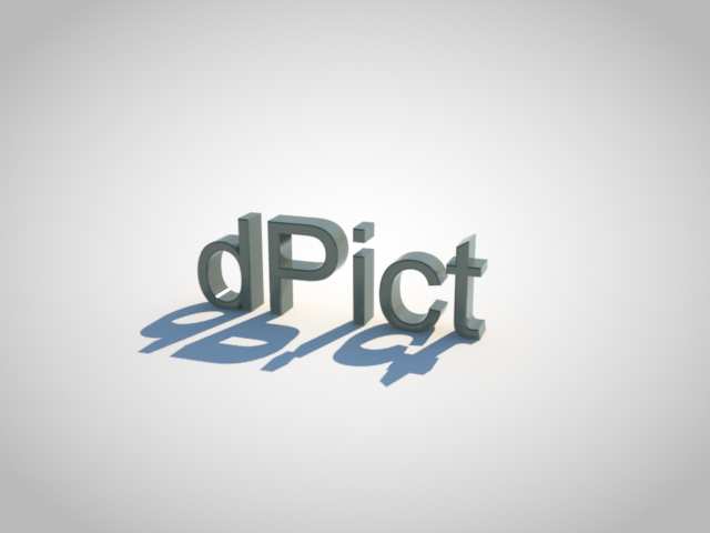

      You'll need to set the floor plane as a Matte Object in the Vray Properties dialog and set the Environment Map as the Gradient Map set to "Screen" mapping. Also apply this gradient as the diffuse texture applied to the floor plane. You'll also need to use the environment overrides if you want to use VraySky. Max2009 scene attached.
Name:	Infinte Floor.jpg
      www.dpict3d.com - "That's a very nice rendering, Dave. I think you've improved a great deal." - HAL9000... At least I have one fan.

          Or this is how you can do it with the fadesphere.
          In my example I have made the floor blue to make it obvious what you need to change.
          The fadesphere doesnt work that well with camera exposure but I usually comp in backgrounds so it works well for me

              One advantage of Chris' method is that the hotspot is defined by the gizmo rather than screenmapped like in my version and the video - it looks somewhat more natural.
